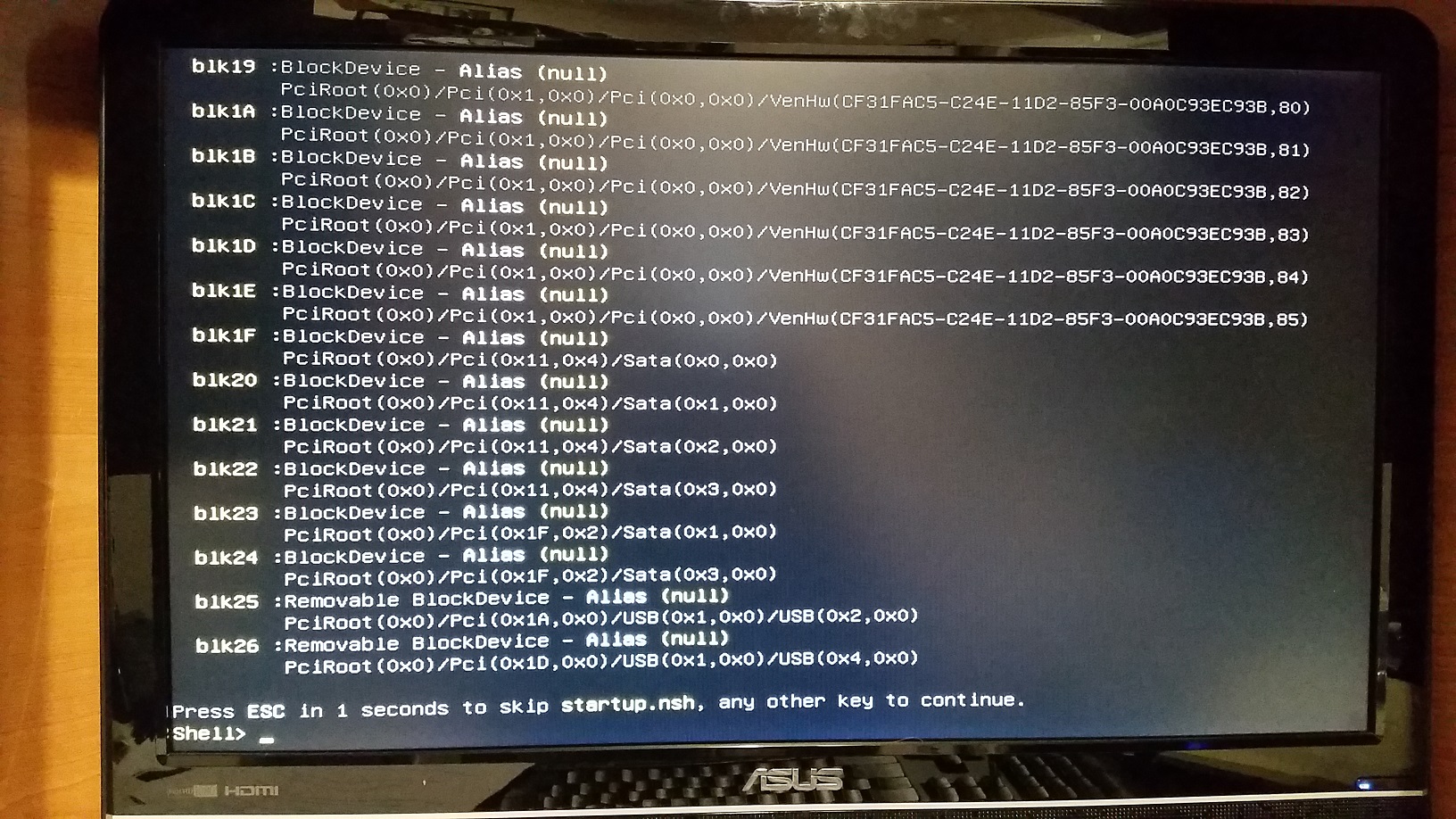

eddie200112
Mar 17, 2015
190

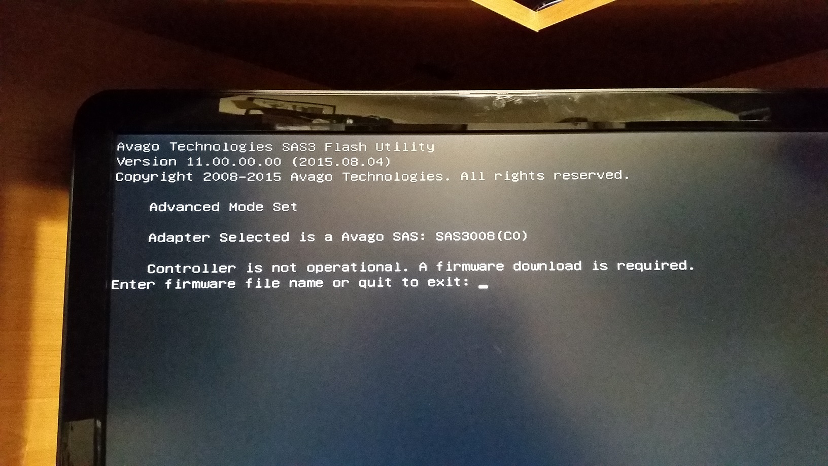

eddie200112
Mar 17, 2015
190
SO I typed in SMC3008T.nsh on that page and ended up with this after 2 minutes.
Now I'm worried I screwed this up...
Hmm, no need to worry yet. Just tell it to flash the firmware image you have on the drive.
eddie200112
Mar 17, 2015
190
So how do I do that. Im not familiar with how to use uefi. I haven't used it before. Do I just type in the name of the rim file I think it was something like 3008it10.rom

Problem solved. Realized I hadn't actually mounted the flash drive first.
