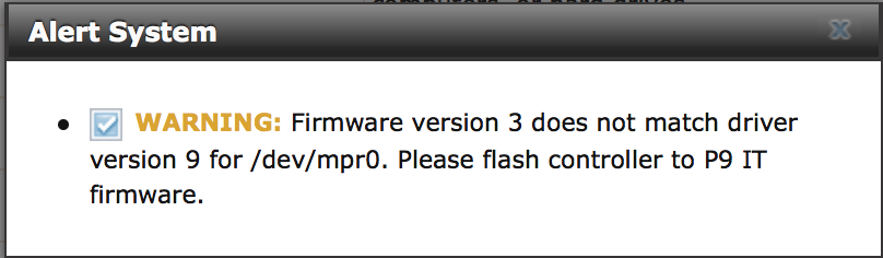

Speaking of which, does anybody know what the mismatched firmware message says after 201511280648? It was apparently reworded at my request, but I don't know to what...
Paul Suh
Jul 15, 2015
16
On the latest stable (FreeNAS-9.3-STABLE-201512121950):
(Sorry about the size. Full size is huge, but thumbnail is too small to see anything.)
