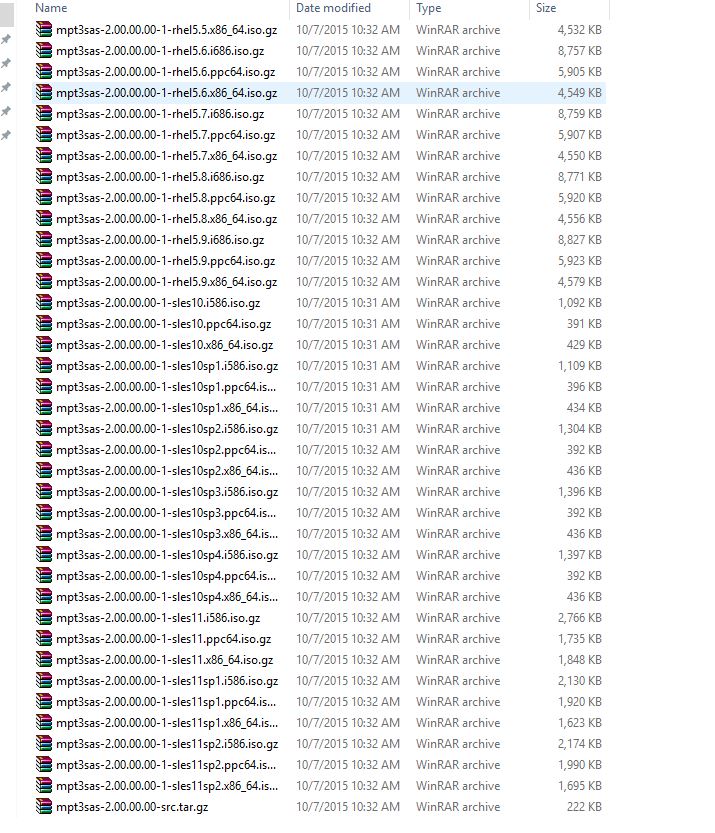

These are the contents of the zip file

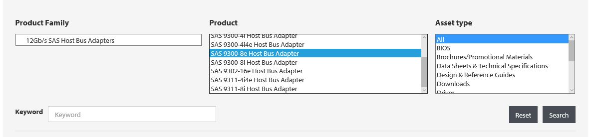

would it be under HBA, then 12Gb SAS , then I don't know what to pick as there is no LSI 3008 choice.. heres the options
9300-8i

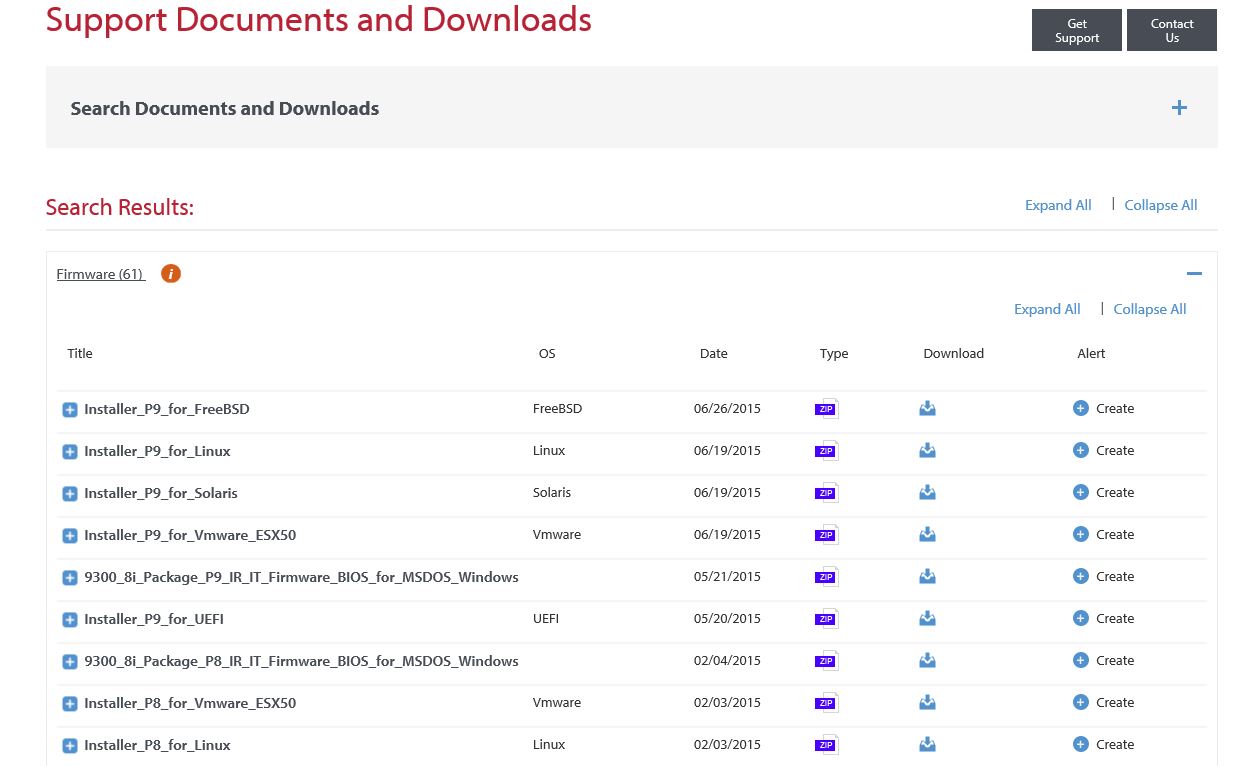

Well these choices are available

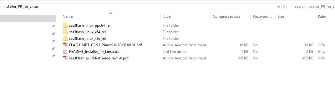

and this is what is in the zip file
