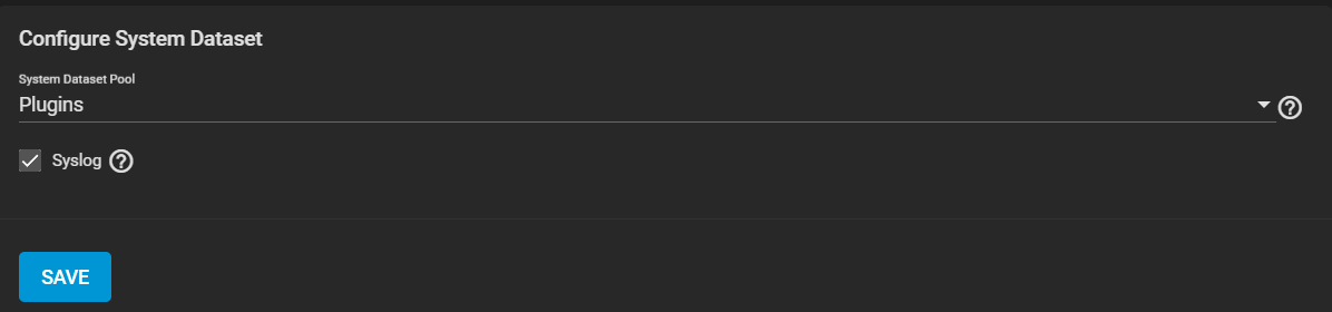

I check and it's Disk0 again. I know it's Disk0 as I can feel the movement when I put my finger against the disk.
Plugins are installed on a separate pool.
The 10 disks have a pool created but no data on them.
Are all disks constantly moving and I just happen to hear Disk0, and I happened to get another possible faulty HDD?

Thanks Davvo,
I'd assume by default the system dataset is installed on the boot Pool, as it's the only thing that exists when the OS is installed.
Just checked and it's on the Plugins pool now, which explains why the disk are silent again.
I've not changed this setting so does TrueNAS randomly select a pool for the System Dataset?
Does it get randomly moved?

If I'm not wrong it gets created/moved on the first non-boot pool you create.
Edited for spelling correction.
Oct 22, 2019
3,641
Not even during installation. The moment you create your first data pool, it switches over to it.
If you move it back to the boot-pool (after you've created your first data pool), it should stay there indefinitely, unless you change it manually.
How strange
All seems ok so far.
I'm currently copying data from the old server to the new server.
Will let you know if the continuous disk activity is still happening once the data copy finishes

Just to finish off the threat, disks are still silent so looks like it was the System Dataset Pool location.
Appreciate the quick help guys
