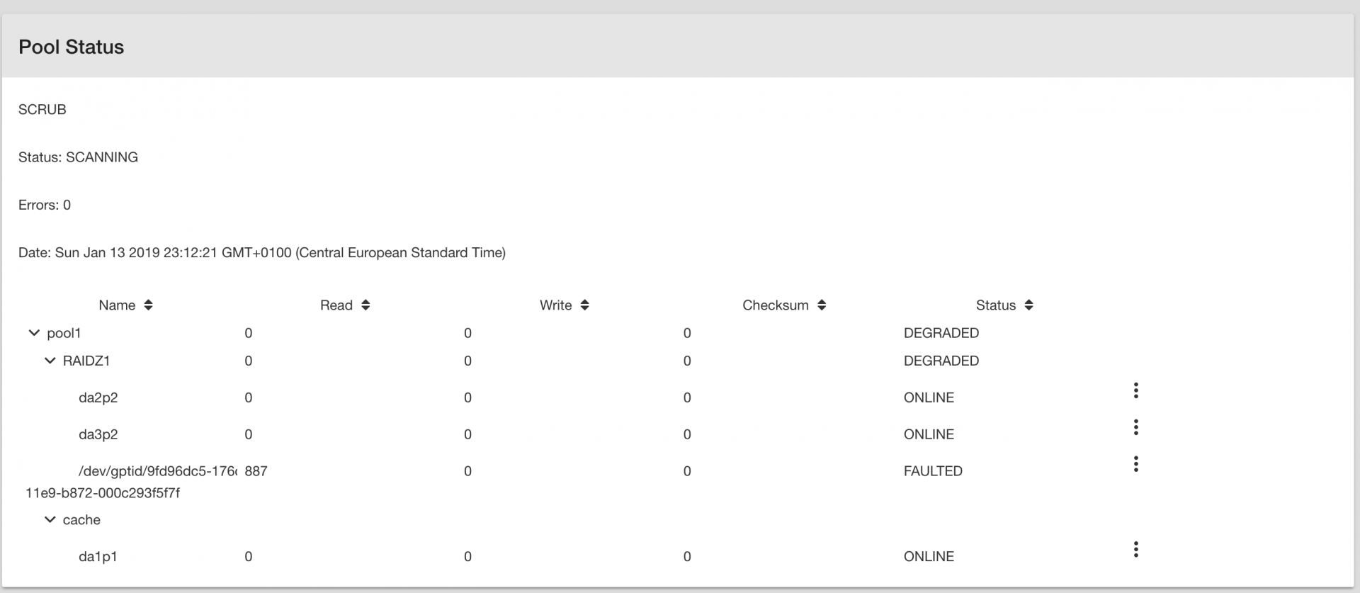

Today, again a hdd failed. (at least this is what freenas reported) I took it out, tested it with seagate tools and it does not report as being defect.
In any case I replaced it with another brand new seagate that I had and, after the resilvering process, it failed again. (like 20 minutes after the resilvering process was done)
Is there something wrong with my setup? Are the Seagate drives not compatible with freenas?

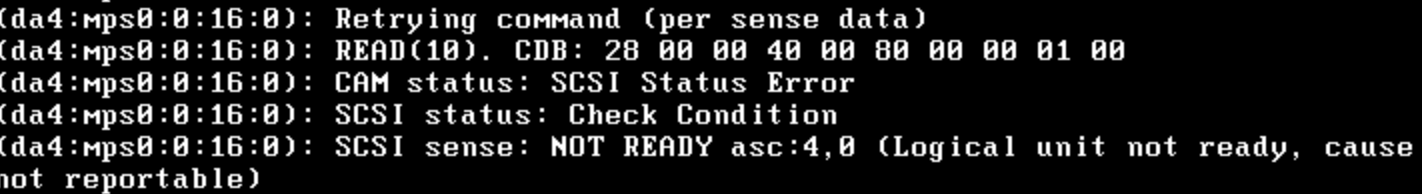

I attached a screenshot from the console of the vm. It is flooded with this message.
Any recommendation of what should I do?

Those errors you reported don't mean much on their own. You need to look at the SMART data for the drives in order to understand if it may be the cabling, power, controller or the drives themselves (with so many failed drives, seems it could be one of the other options).
It may be that the "failed" drive will still report all OK on SMART tests (run internally on the drive by itself, not involving the other components) and point the troubleshooting elsewhere.
