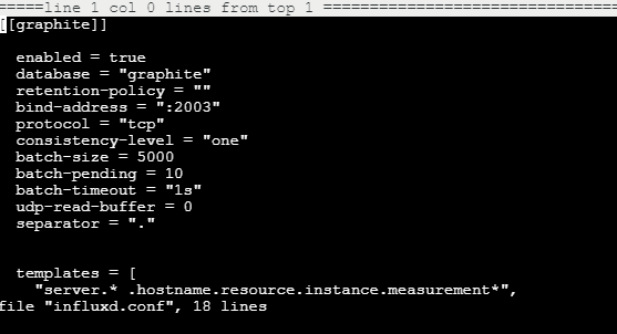

Tried changing bind address from ":2003" to ":3000" hoping that it would solve the problem but it still persists.

3000 is the standard port for Grafana. You cannot run Grafana and Influx on the same port. Grafana - 3000. Influx - 2003. Make sure the Graphite plugin in Influx is enabled:
[[graphite]]
  enabled = true
  database = "graphite"
  retention-policy = ""
  bind-address = ":2003"
  protocol = "tcp"
  consistency-level = "one"
  separator = "."
  templates = [
    "servers.* .hostname.resource.instance.measurement*",
If you don't put enabled = true in there, it won't work.

This is my current config during my digging for solutions and problem still persists.
Edit: added "s" on servers, saved and restarted influxd, still problem persists.
