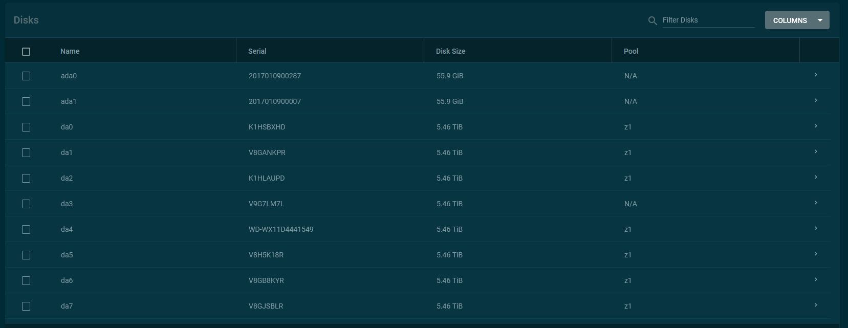

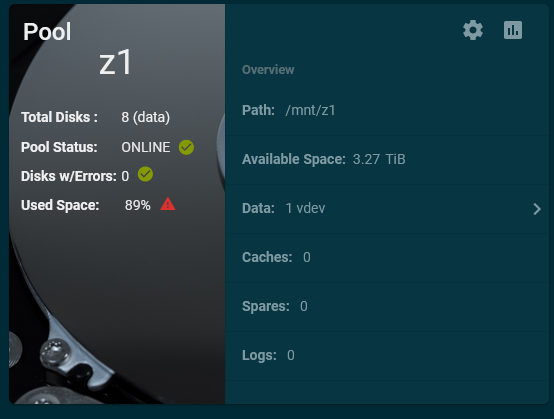

More weirdness after completing the CLI replace. The GUI disk's view says that the new/replaced disk is not part of the pool.
However zpool status says that it is:

Also, the Dashboard says the pool has 8 disks:
What's going on here?
9,703
However zpool status says...
