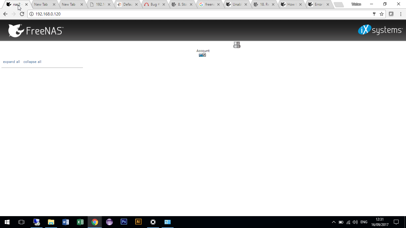

I am completely new to FreeNAS. I completed the install the other night and all seemed fine. I setup my volumes and created some datasets then powered down the machine to configure it this weekend. Today I log in and after entering username and password, the GUI does not load correctly. After some fiddling I found out that if I do a complete cache refresh (CTRL-F5) of the browser and it reloaded the GUI perfectly. I have tried Chrome and Internet Explorer, both are the same. I have restarted the machine and it is still the same.
Another problem is that the dataset configuration popup window is also no longer loading, it pops up and seems to display http request code instead of the GUI.
Anyone have an idea on what is going on and how to sort it out?

Hi, I first noticed this on my desktop which is wired. Took the screenshots on my laptop on wireless. The NAS is wired.
I have just deleted my volume and recreated it without encryption, rebooted, and all seemed to be fine. Even creating datasets worked. So I deleted the volume again and recreated it encrypted, and I have the same problem again. So this may be down to encrypted volumes?

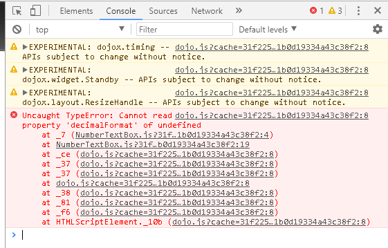

ctrl + F5 works as well. Issue also persists in Edge, but I will give FireFox a whirl. Just something new that has never happened before
adamdes
Oct 22, 2017
I have the same issue with both Chrome and Edge. CTRL+F5 works as a work-around, but this is not normal.

Using IE is a work around, there is an issue that needs to be fixed with a script on the gui :
I reported it as a bug. Will see where this leads.
I'm able to use it (IE or CTRL+F5 loads the GUI in Chrome), I'm just trying to improve the product by suggesting to try to fix an issue that a lot of people report having.
11.1 should fix this. If not, file a bug report.
