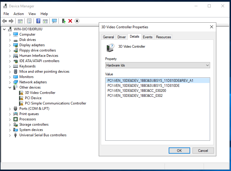

I am currently running BlueFin but I think this is a general TrueNAS Scale thing. I'm attempting to setup 2 Tesla P4 GPUs in my system where 1 GPU is assigned to a Windows VM for NVR (Blue Iris), and another to Kubernetes to run Plex. However, the issue I'm seeing is that if one if the GPU is assigned to the Windows VM, then the OS fails to see any GPUs (besides onboard). I also tried the "Isolated GPU Device(s)" configuration but that does not help either.

Inside VM
