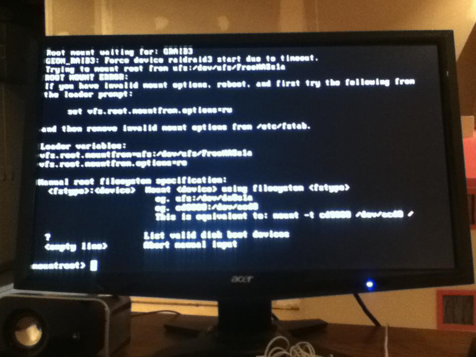

Im a complete noob when it comes to the coding side of things so I have no clue what this means.
I'v included a picture of it but if you cant read it I guess i will type it out, just ask if you need me to,
Can someone please tell me how to fix this.
Edit:
I took a look at the picture and Its not very legible so I wrote it out,
Root mount waiting for: GRAID3
GEOM_RAID3: Force device raidraid3 start due to timeout.
Trying to mount root from ufs"/dev?ufs?FreeNASs1a
ROOT MOUNT ERROR:
If you have invalid mount options, reboot, and first try the following from the loader prompt:
set vfs.root.mountfrom.options=rw
and then remvoe invalid mount options from /etc/fstab
Loader variables"
vfs.root.mountfrom=ufs:/dev/ufs/FreeNASs1a
vfs.root.mountfrom.options+ro
Manual root filesystem specification"
<fstype>:<device> mount <device> using filesystem <fstype>
eg. ufs:/dev/da0s1a
eg. cd9660:/dev/acd0
This is equivalent to"m mount -t cd9660 /dev/acd0 /
? List valid disk boot deviced
<empyty line> Abort manual input
mountroot> []
Edit ~~
I have figured it out, In the install menu it asks you if you want to start from scratch or upgrade I was choosing start from scratch, I am assuming that the drive needs to be formatted which I hadn't done, I chose the other option and it booted fine, took a while, could just be the new software,
Thanks anyway
