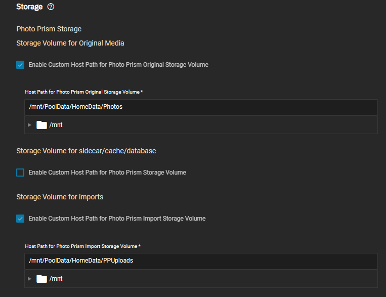

I'm currently doing a Replication Task on the originals folder, but if something happens to the server how do I restore the database with meta data, people, albums, etc.?
I have not included and set "Custom Host Path for Photo Prism Storage Volume".

If I Enable Custom Host Path for Photo Prism Storage Volume to do replication tasks on a storage volume will I break something?

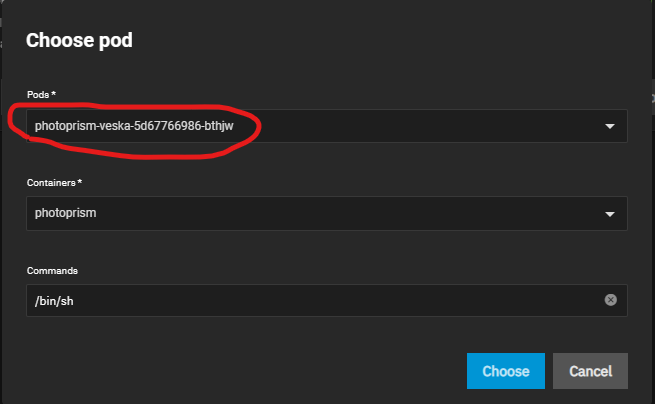

I went into Apps->Installed Applications->3 dots->shell to check if I'm in the right container
k8s_photoprism_photoprism-veska-5d67766986-bthjw_ix-photoprism-veska_6e7b6a6b-e400-46a3-8088-8441945a3ef1_0
I went back to System Settings->Shell up arrow and enter and the "miracle" happened, a 509MB file was generated.
