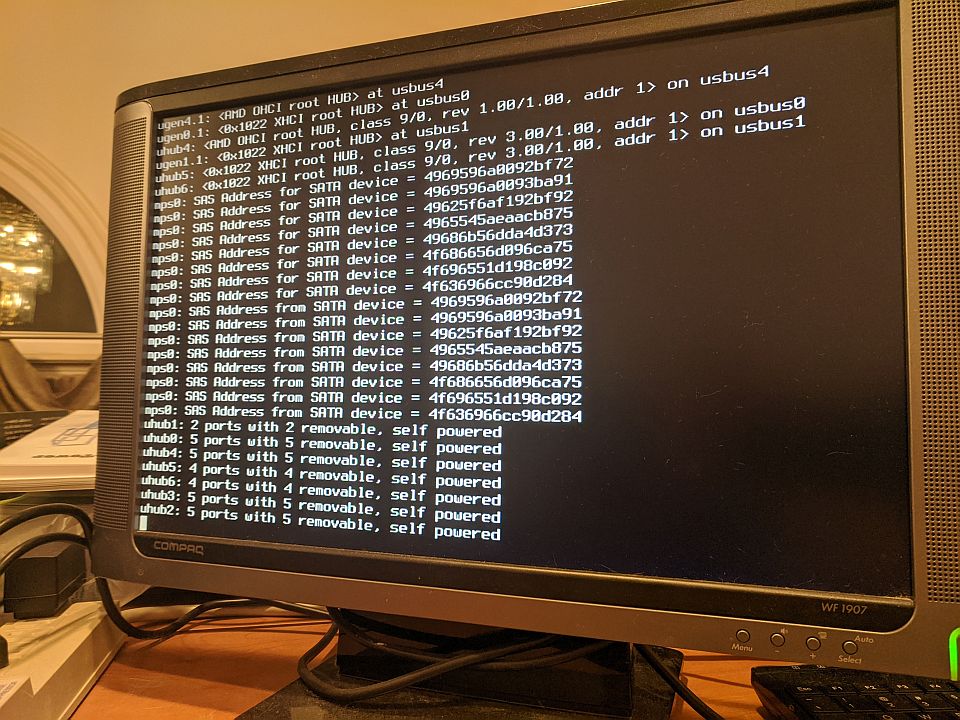

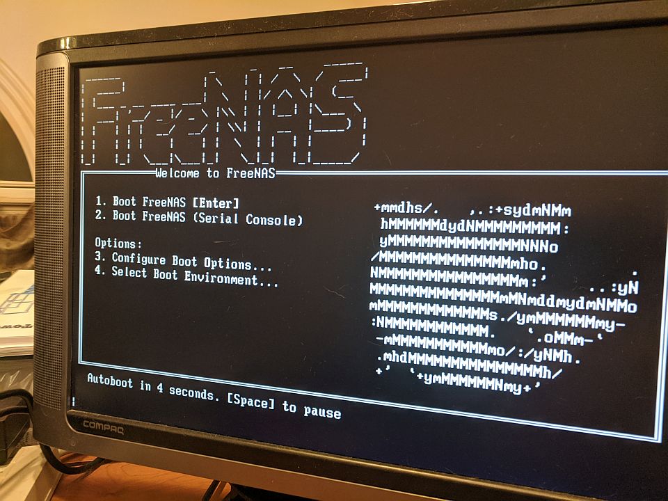

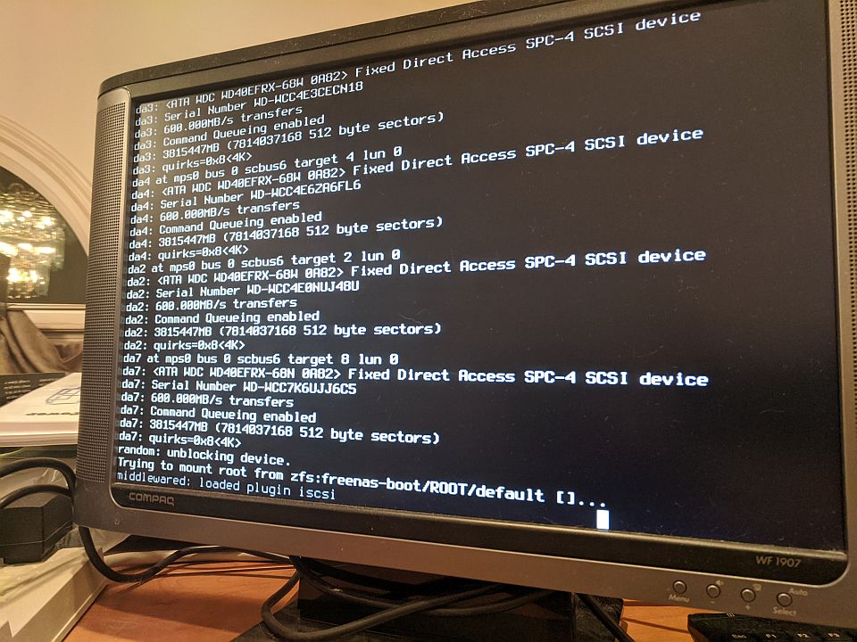

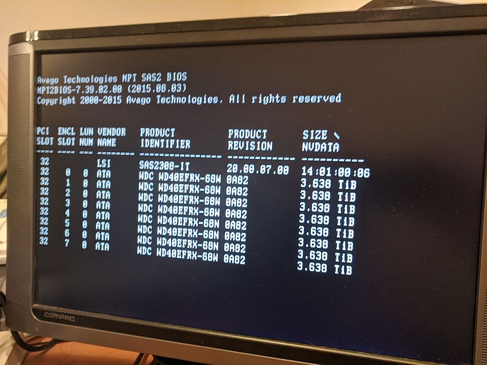

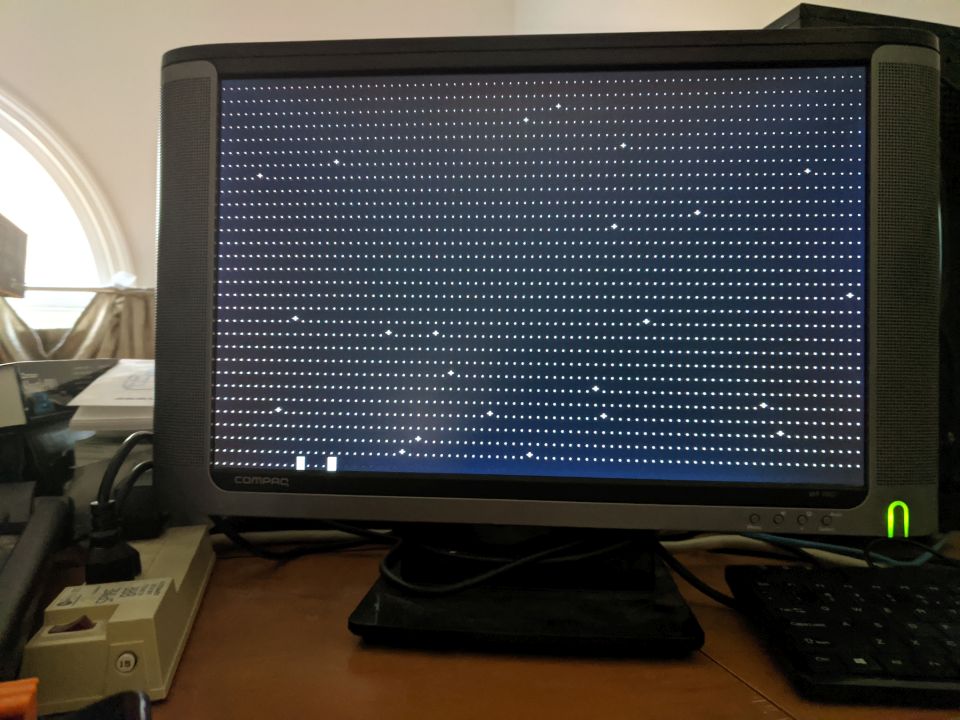

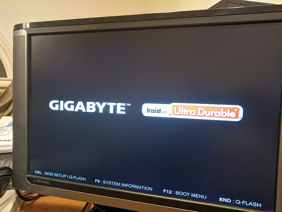

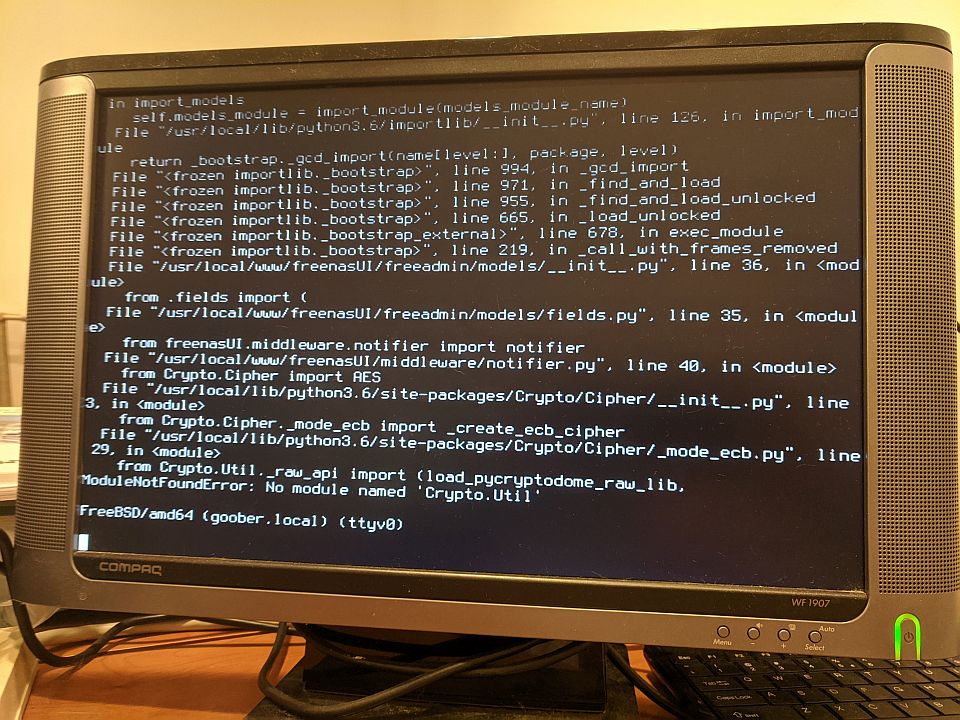

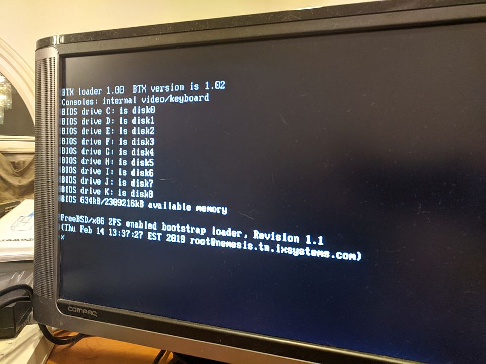

After the "upgrade" the system will not complete the boot process (see the attached pics).
There are 7 pics below and they are in the order they come up during boot.
Pic #1:
Pic #7:
The pics represent any "pause points" in the boot process that I could take pics of. With the old processor, the entire boot process would only take a couple minutes. The last page represents a process loop. It displays a bunch of data, leaving the last screen where it pauses for ~30 seconds before trying again. I have left it here for hours and it continues the cycle.
Do I have to reinstall the OS to get this to work with this new CPU? I've never run across something like this, so I'm at a loss (as I am with just about anything Unix/Linux).

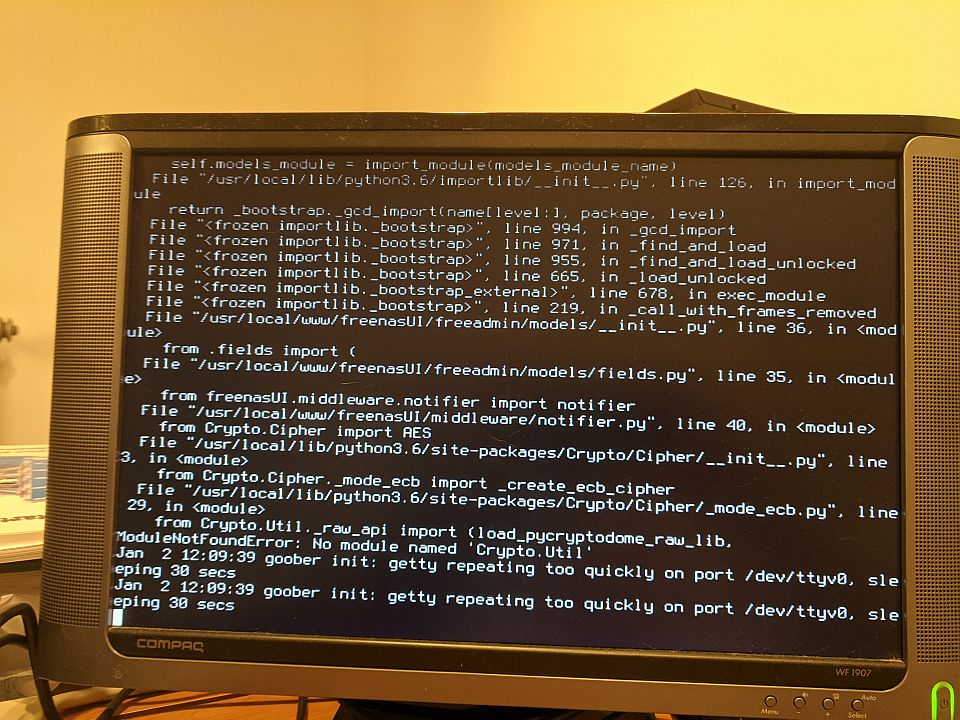

One final pic of the screen where it waits for 30 secs to try whatever it is trying before waiting again. I thought I had included this one before. DOH!
Pic #8:

I'm not convinced it's a hardware problem unless your boot drive is corrupted somehow. Those "Can't find crypto util" messages indicate missing files. It might be possible to upgrade to the same version (You _do_ have a backup of your config database as mentioned above, right?).
Regardless, your data should be safe, so it should be a simple matter of getting your boot environment correct.
That's another thing to try, actually; see if in the boot menu you can go back to the prior boot environment (screenshot 4, option 4 there). That might be the fastest quick-check TBH. Well, unless you have no prior boot environment, but that sounds somewhat unlikely.

Unfortunately, no, I don't have a configuration backup. Frankly, I'm such a n00b with FreeNAS that I didn't even know it was an option (something I'll rectify as soon as I get the system working again).
FWIW, replacing the original CPU did not help. Same problem.
I'll try Screenshot 4, Option 4 and report back if it works.

I'm hoping that the "problem" is just that FreeNAS is choking because it can't find the crypto library files, not because it needs them to access the array.
Yeah, something just got boofed in the latest boot environment most likely. Your data isn't stored on the boot environment, just the config so once you do get booted things will start looking up.

The dots mean it was generating your SSH key, normally done once at install so that part is normal.
If it still got stuck then yeah, a reinstall will be necessary. Curious: can you SSHinto the system when it's stuck like that? If so, you might be able to pull the configuration database...
The system did continue past the scrolling SSH key generation screen, but then got stuck on the "Crypto.util not found" with the 30 second delay retries (see Pic #8 above). So, at this point I'm assuming that something on the boot drive is hosed? On to a re-install?
Yeah, most likely, unfortunately.
