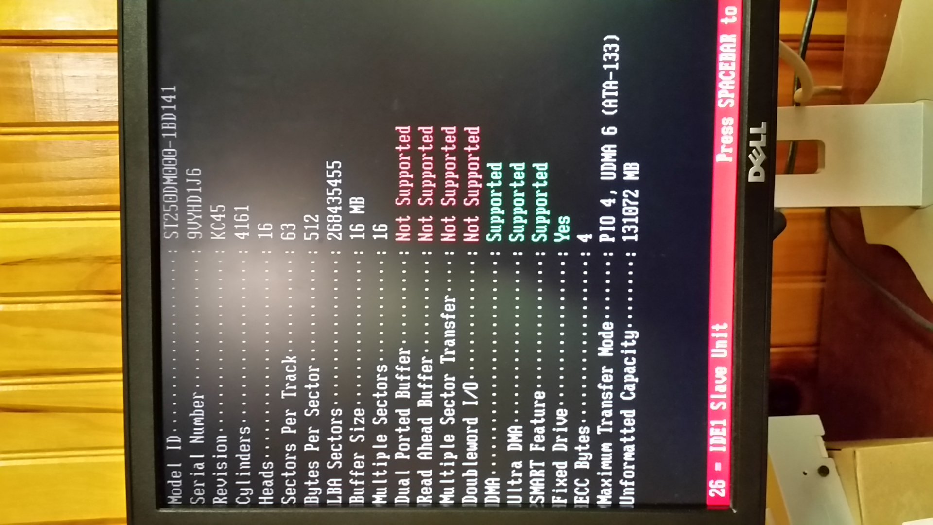

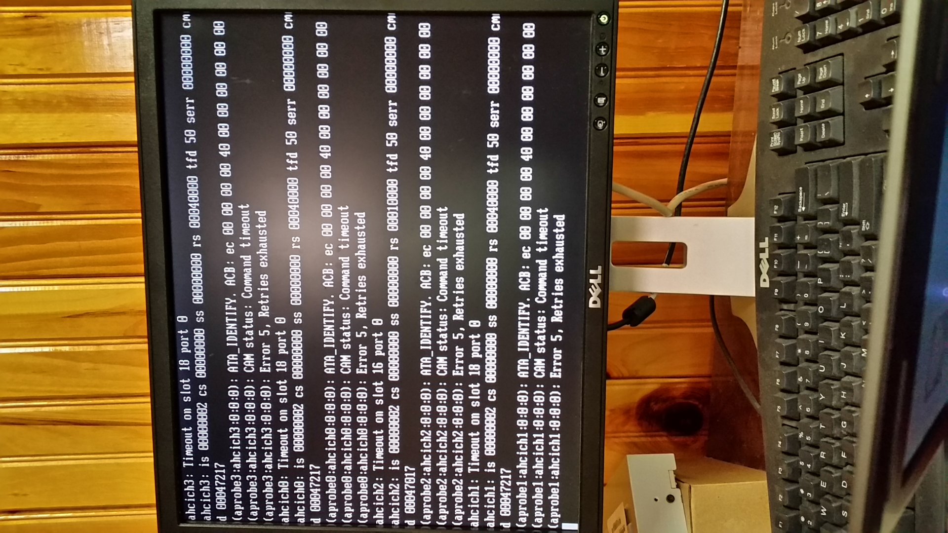

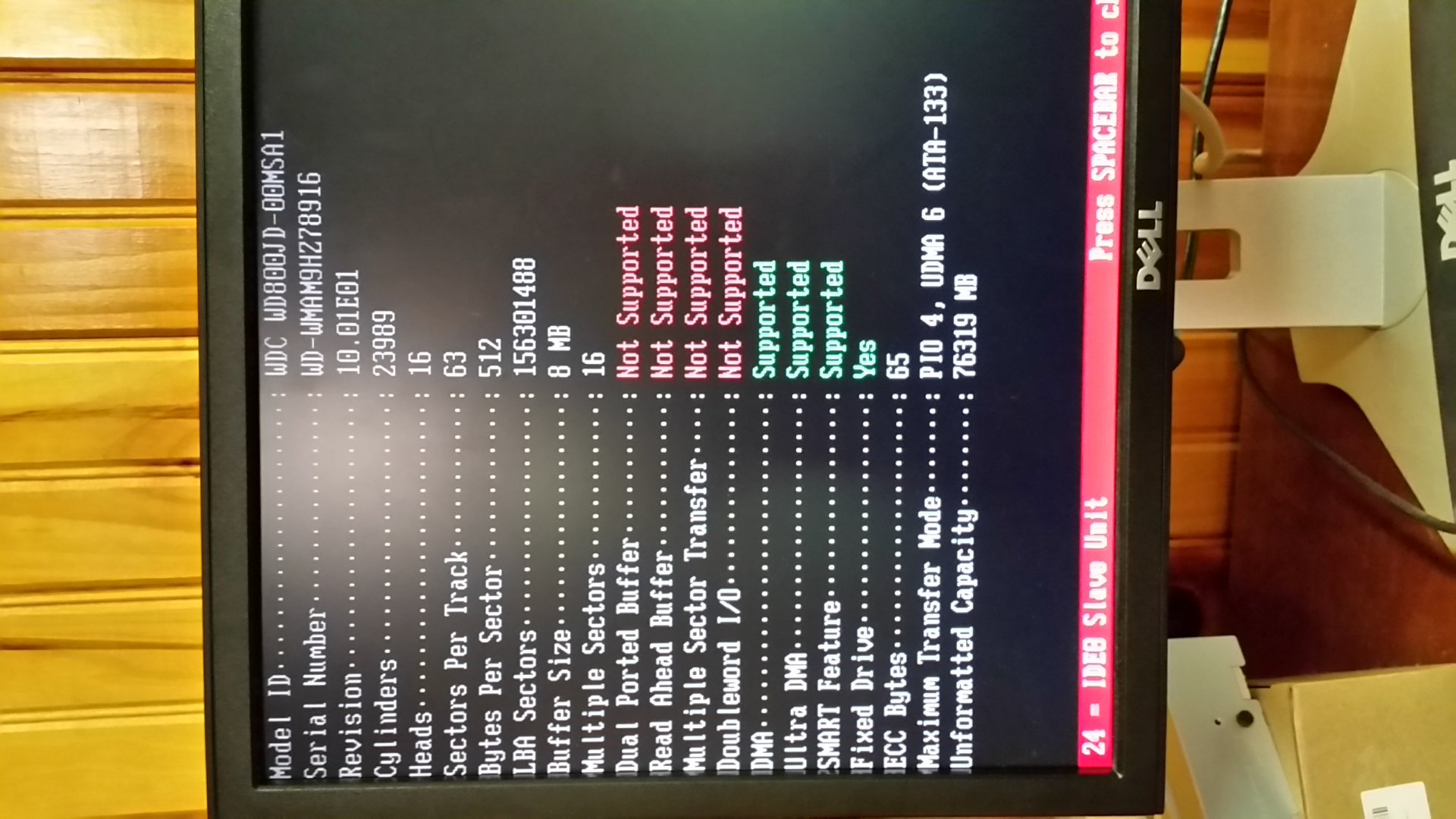

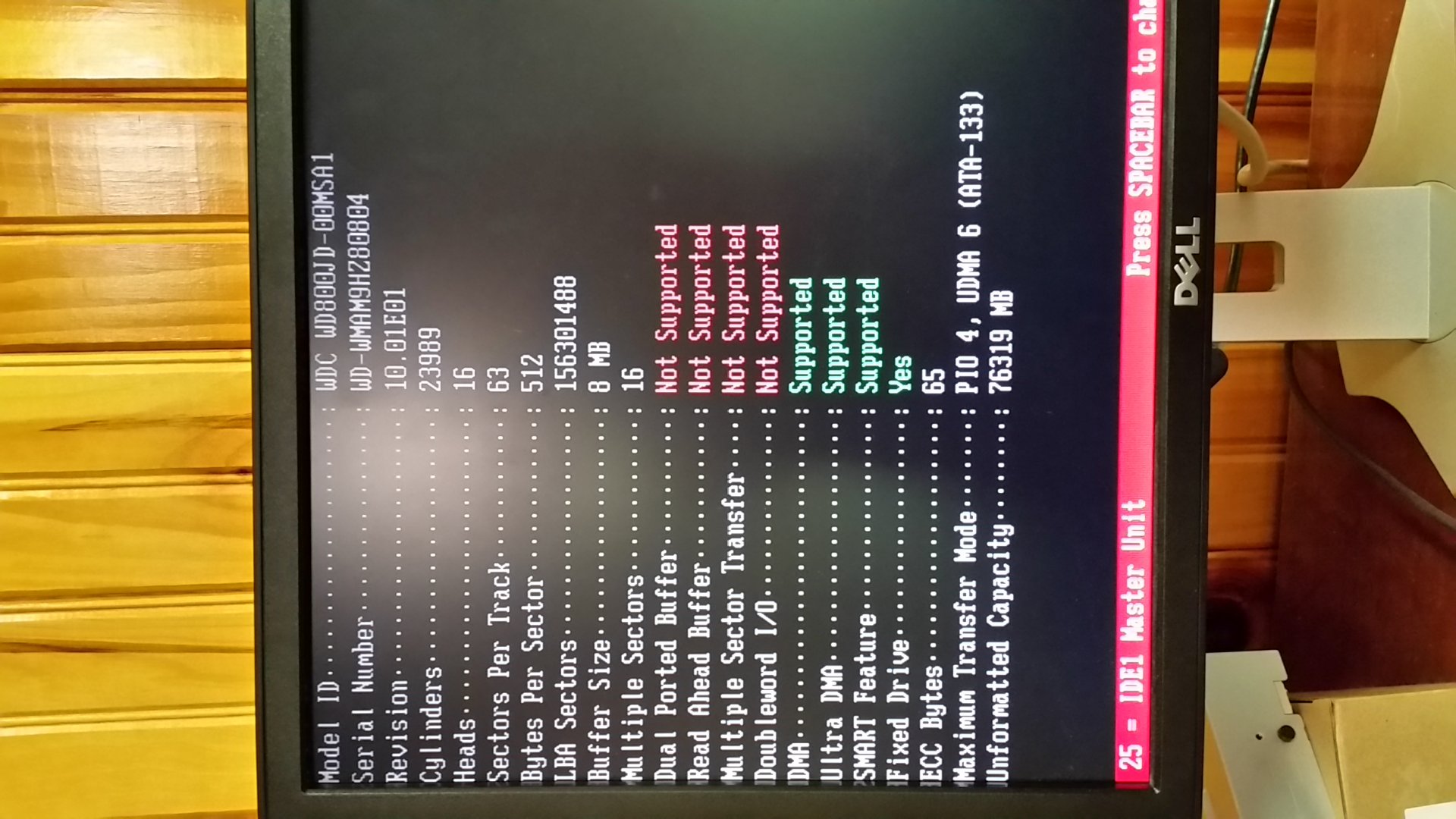

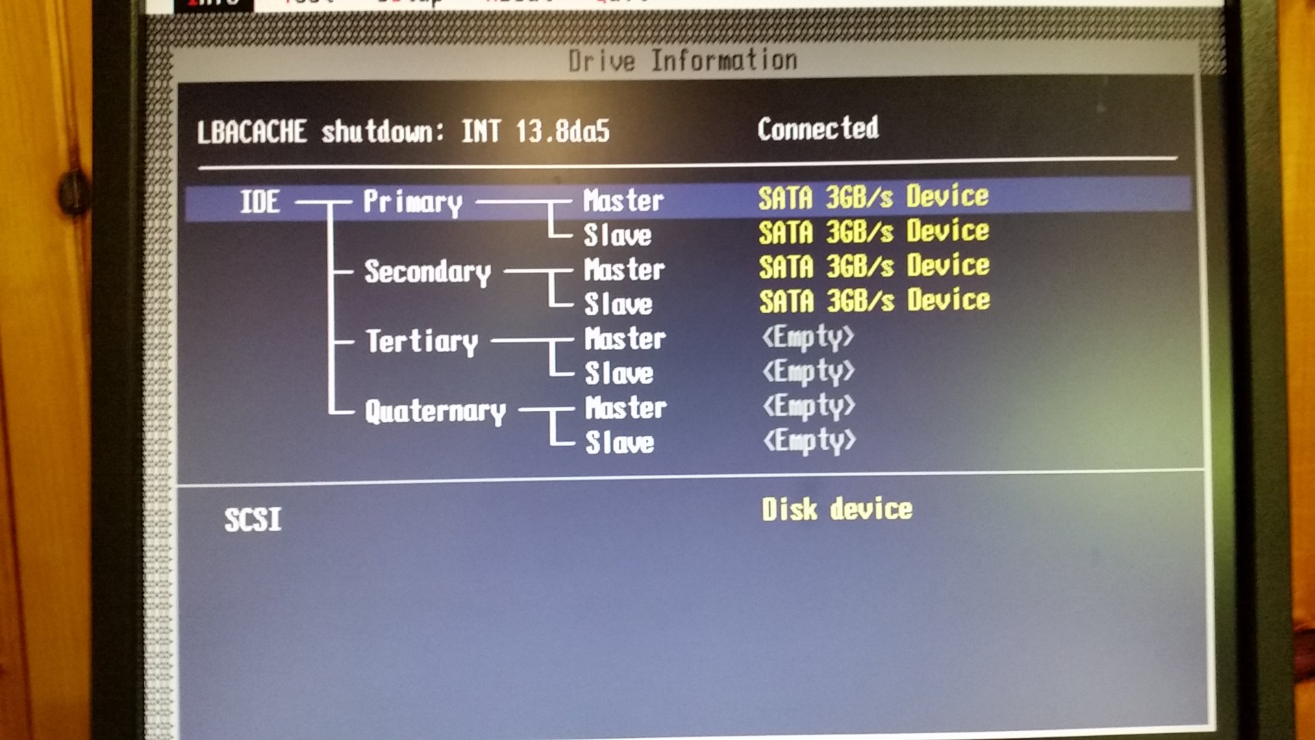

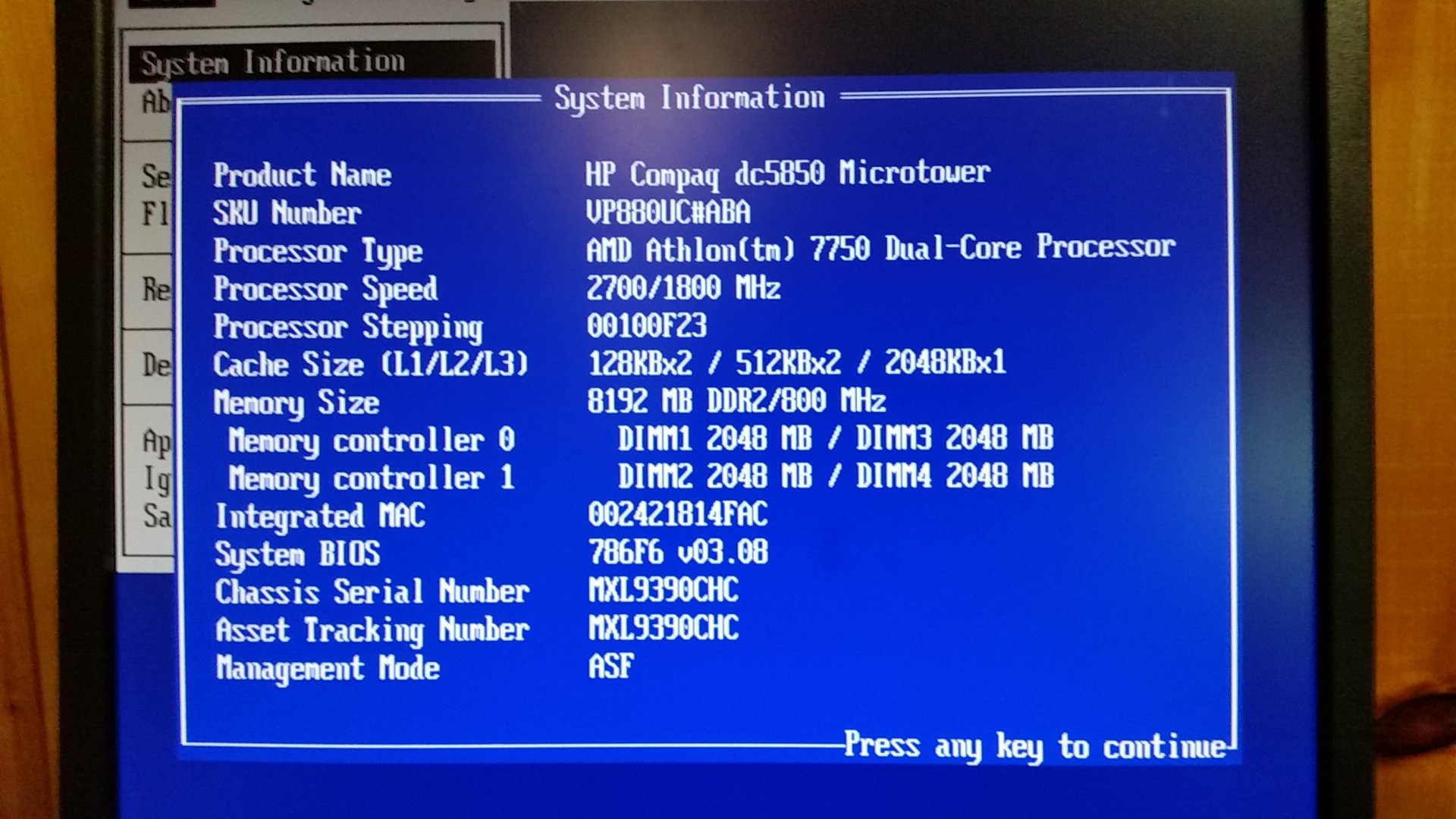

I am trying to setup a NAS using a handful of computer parts (in other words I'm trying to do it with no budget).

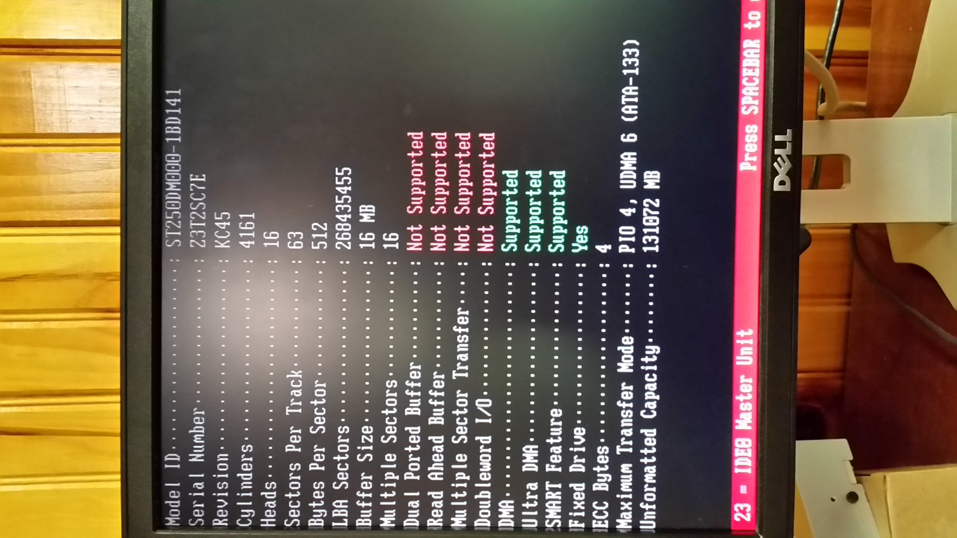

When I load FreeNAS 9.10 or when I even begin installation onto a flash drive I get the below errors. I can eventually install FreeNAS, boot FreeNAS and login with my created root password. However, none of my drives appear when I attempt to make a volume. I'm not sure what the problem is since tests have found no problems with the drives.
I've taken pictures of the error message and of system information
Pic 1 - error message
Pics 2-6 - HDD information
Pic 7 - CPU and RAM information
I would be incredibly and passionately thankful for any help that leads to progress in my endeavor to build a NAS from old materials.

What the hell kind of configuration is that? What the hell is going on in pictures 2-7?

OK, so we're looking at an 8-year-old AMD system. I give you credit for putting 8GB of RAM in it, but most likely it just isn't compatible with FreeNAS 9.10. You might be able to get an older release working, but if you're determined to use this hardware, then FreeNAS probably isn't for you. There are lots of alternatives, mostly based on some flavor of Linux.

I have x2 Seagate 250GB SATA drives and I have x2 WD 80GB SATA drives
Thank you. I believe @Robert Trevellyan is probably correct, and that you ought to consider using another OS.
