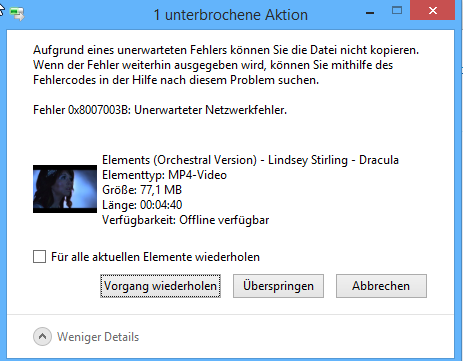

And what does mean this fault?

I looked at the attached screen capture and it looks like you are transferring over wireless. Is that true?
EDIT: I'm not implying your NAS is connected wirelessly but you are transferring a file and it's path goes over wireless.

@joeschmuck Yes, I am conectet to a accssespoint and ther to a switch and then to the routher wehr the NAS is.

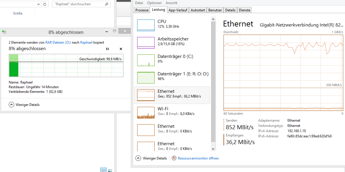

Raphael
Mar 6, 2014
9
Also the problem is in the network.
My HDD is a little bit slow. o_O
I will try it agan with my SSD.

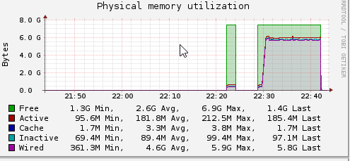

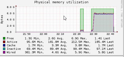

So yet I know why 8GB Ram is recomendet o_O
FreeBSD will allocate all the RAM is can and does not release it very quickly so if FreeNAS only needed a large amount of RAM for 1 second, the system will hang on to it until it feels like releasing it. This doesn't mean thee RAM isn't available for use by other applications, it is. FreeBSD is just odd that way.
