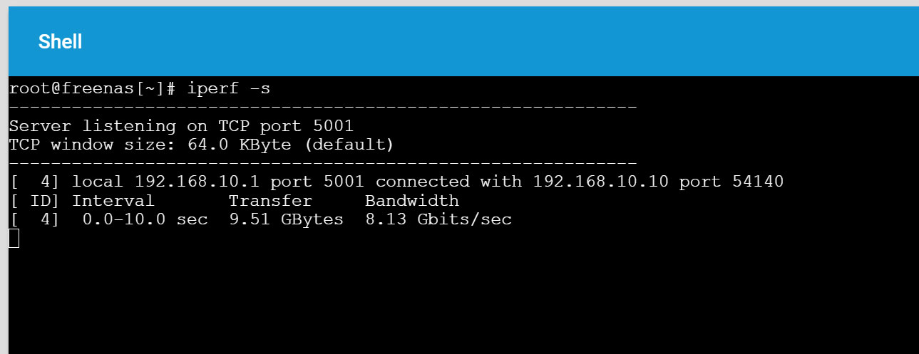

Iperf

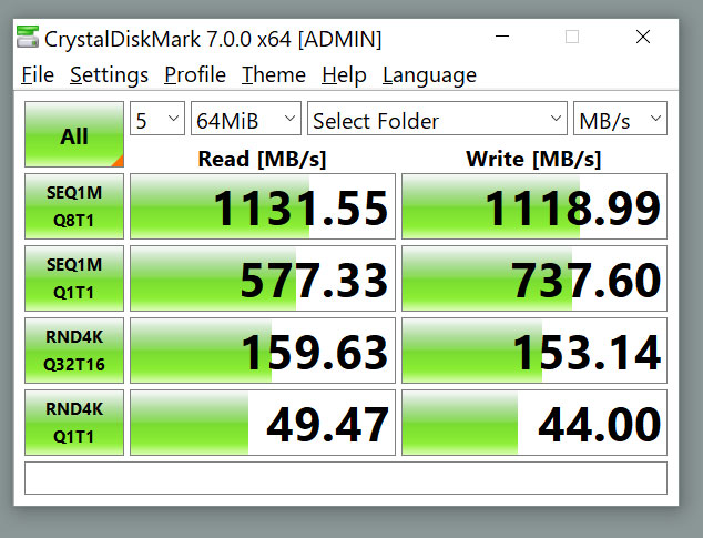

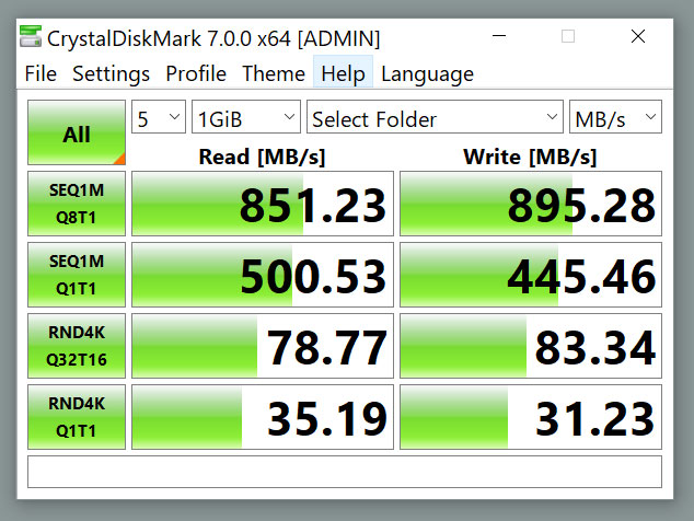

Crystal Disk Mark (64Mb and 1Gb file sizes)

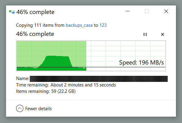

These seems very reasonable, but in real world the results are really bad. I can’t reach much more than 200Mb copying from NAS and 120Mb copying to NAS.
In the graph you can see a peak that is intentional (about 800Mb, which looks +- the iperf test) that matches a file that was cached by freenas (was copied just few seconds before).
It doesn’t matter the pool that I’m using because the results are the same (pool 1 have 5900RPM disks and pool 2 have 7200 RPM disks)
This must be a bottleneck somewhere, but I’m not figure out where it could be. First time I thought in the processor, but then I realise that the “Highest Usage” is almost the time under 25% and only few times reach about 75%.
