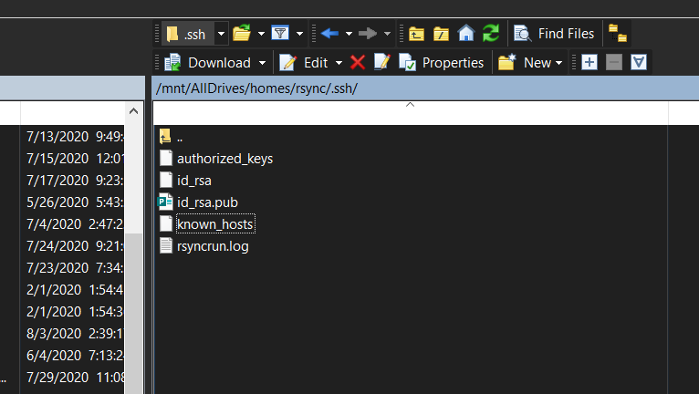

It's a good thing to be unemployed due to a virus :tongue: I wouldn't be able to afford the time!
1. Fire up the shell
2. su rsync
3. rsync -av --progress --log-file=/mnt/AllDrives/homes/rsync/.ssh/rsyncrun.log /mnt/AllDrives/Series rsync@192.168.0.nn:NetBackup
4. Number three is where the pub key and authorized_keys file is (/mnt/AllDrives/homes/rsync/.ssh/). Those two and the key file on the Synology as well as the user account on Freenas's SSH setting match.
5. Authenticity of host (ip of synology) cannot be established. No matching key fingerprint found in dns. Are you sure you want to continue connecting? "yes"
6: known_hosts file created next to the pub key file with an entirely different key.
Rinse lather repeat for about 20 more hours now. o_O

Servers aren't users -- so they both have their own keys.
In your home directory there should be a folder named .ssh. In that directory there should be (at least) 4 files. Here are mine, for user 'root' on one of my FreeNAS systems:
root@bandit:~ # cd .ssh
root@bandit:~/.ssh # ll
total 11
-rw-------  1 root  wheel  3505 Jun 19 00:49 authorized_keys
-rw-------  1 root  wheel  3243 Apr 19  2017 id_rsa
-rw-r--r--  1 root  wheel   751 Apr 19  2017 id_rsa.pub
-rw-r--r--  1 root  wheel  1502 Jun 19 00:48 known_hosts
authorized_keys contains keys for the root user account on other systems
id_rsa is your private key
id_rsa.pub is your public key -- this will be copied to authorized_keys on other systems you access using SSH
known_hosts contains host keys for the hosts you access using SSH
When user 'root' logs on to this server from another server, SSH compares the remote user's id_rsa.pub key with keys stored in the local 'root' user's authorized_keys file. If they match, it allows an SSH connection without requiring a password. The same thing happens, only reversed, when local user 'root' connects to another server using SSH.
SSH also checks the remote server's host key against those stored in known_hosts. That's why there are two keys. The first time you log onto a remote system with SSH, it won't find the remote host's key in known_hosts and will ask if you want to add it and allow the connection.
This is all for the sake of security.
Anyway, I noticed you pointed your rsync log to a file in the .ssh directory -- this isn't a good idea. That directory is reserved for use by the SSH service -- which is critically important -- and we don't want to inadvertently dork it up...
In light of all this... are you able to log on to the remote system -- a Synology system, right? -- using SSH? Something like this: ssh rsync@192.168.1.nn should log you on to the remote system.
Also... I see you've created a user named 'rsync' -- you need to be logged on to your FreeNAS system as 'rsync' if you're going to run SSH or rsync commands using that account. Again, because the keys need to match up with what is set up on the remote (Synology) system.
And lastly -- I swear! -- just FYI, you don't need to worry about hiding your Class 'C' IP address ('192.168.1.nn'). No one can reach in and hack your system using that IP as these aren't visible on, or reachable from, the internet. They are reserved by the IANA for local LAN use (along with a few others) and everyone in the world uses the same IP subnets for that purpose. :smile:

Thanks Spear. An FYI I started in the really 80's in computer science and went sideways into aeronautical engineering. I was writing Fortran code on a Vax running VMS in an editor called VI :grin:. Funny how many V's there were back then! My first computer a 286 with floppy, 500MB hard drive you would not have wanted to drop on your toes, and much to my girlfriends chagrin, I spent the extra $500 on the optional 2 megs memory and the huge 14 inch monitor. Total cost over 2K in mid 80's money.
There was no software for a PC, so I wound up converting Fortran code that was in the public domain from NASA to GW Basic. My first software was a program that modified 65 series airfoils for better lift. It would show the before and after airfoils by mathematically pixel mapping the screen, and print a full size template on a pin printer also by determining where to fire X and Y on the printer. Took and hour :wink:
I wound up in IT dept at the local community college in the late 90's as field help desk part time in the morning, and part time at a couple of casinos in my area which shortly resulted in being IT manager. Then in 2000 the .com bubble bust and network manager jobs were $16 an hour.
Were was this all going many may ask! Jut wanted let you know I'm a fossil, but not a total noob. You patience is appreciated and it's frustrating to spend this much time on things.
So, back to our station.... Freenas
I got the caveat on the log file location and will move it
The rsync user is in the administrators group and permissions on that .ssh directory seem to be good. Keys on local and remote authorized_keys match. First time in without known_hosts file results in what you would expect and have described above. The Freenas shell of course starts as root, and I su rsync before trying to run the rsync from command line. It requests a password. As a simple test, trying to SSH into the Synology under the same conditions also results in a password request.
/volume1/homes/rsync/.ssh on the Synology have keys that match though no known_hosts file is generated if it should be.
I know a private network IP isn't reachable, after 25 years reading forum messages it just seemed etiquette :cool: I really appreciate the effort in running down the SSH files, I was curious why the duplication of key info. So if rsync went to another site would it be appended with another known hosts entry? and in actuality any user using SSH is going to have three files then (aside side from the private key)

I'm going to agree that it's got to be on the Synology end, the rsync user has a home directory with admin level access and it has the ,pub key with authorized_keys in it.s .ssh directory (they all match) The fact that both the rsync and doing an SSH login both want a password suggests the Synology end isn't being seen correctly. I'll work on it from that end. You are correct, the Synology uses and admin account. Trying to do anything usually requires SSH in on that account and then su -i If I remember correctly to bee root.
