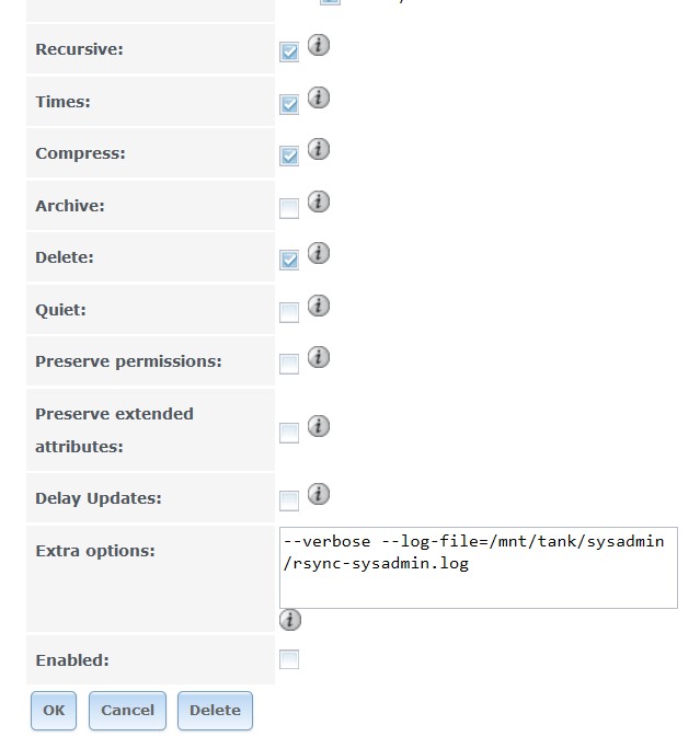

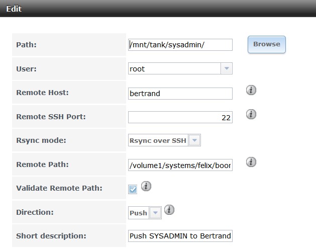

Rsync Task setup as follows:
- Path: /mnt/pool/backup-win
 - User: rsync
 - Remote Host: 192.168.1.170/volume1
 - Rsync mode: Rsync module
 - Remote Module Name: NetBackup/backup-win
 - Direction: Push
 - Recursive: Yes
 - Times: Yes
 - Delete: Yes
 - Quiet: Yes
 - Preserve permissions: Yes
 - Extra options: --log-file=/mnt/pool/backup-win/rsync_backup-win.log --stats -h -v -n
 - Enabled: Yes
