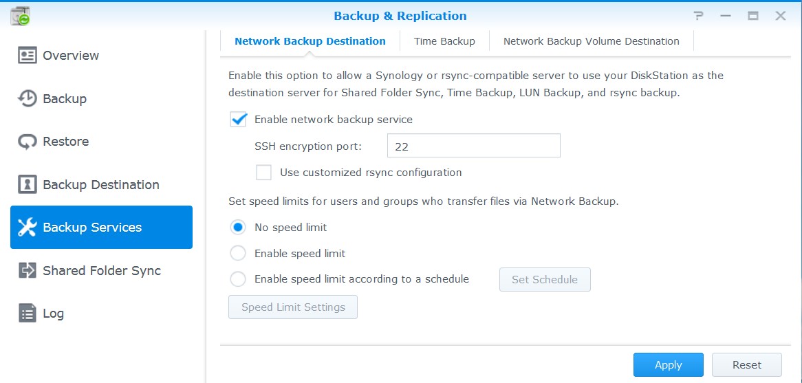

Besides enabling SSH on the Synology, I also turned on the network backup service on the 'Backup Services' panel under 'Backup & Replication':
All you need to do on the FreeNAS side is enable the rsync service under 'Services'.

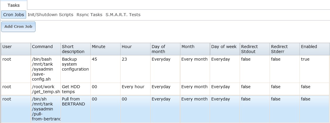

I call the 'pull-from-bertrand.sh' script from a chron job, like this:
Hope this helps and is enough to get you started. Good luck!
