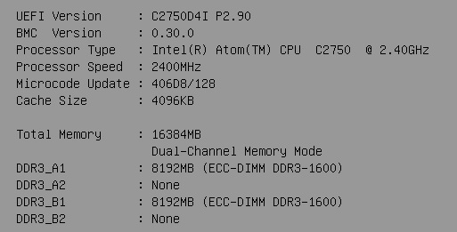

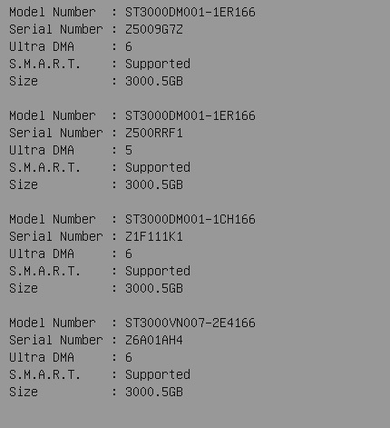

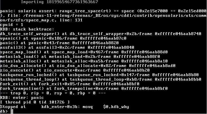

Dear all,
Please advice

The first step would be to see if you can get a FreeNAS install USB stick to boot.
If that boots, try to install to the same location as your current install (effectively an upgrade/repair).
If that works, back up your config and think about changing your boot drive. (at very least be ready to do that soon)

thanks a lot dear for reply I will try it when I reach home ,
I am using to 2 16G sandisk cruzer blade for booting .

1- reinstall on same usb stick ( same issue )
2- reinstall on new usb stick & restore the backup ( same issue )
3- ???? :)

@Mohammed, read this thread https://forums.freenas.org/index.php?threads/how-long-your-asrock-c2550d4i-or-c2750d4i-lasted.45445/ which covers many users affected by the Intel issue with your specific motherboard.
You will see:
(a) it is very likely that Asrock will cover your board under warranty if indeed it has failed in the typical manner - you should contact them and discuss as their extended warranty is, AFAIK, 4 years.
(b) that you should anticipate that you will not lose data - one of the best features of FreeNAS's use of ZFS is that the data storage is substantially independent of the OS - so, once you again have a functional FreeNAS system, hook up your HDD's to it and your data should be there.
Good luck! Let us know how you get on with Asrock.
