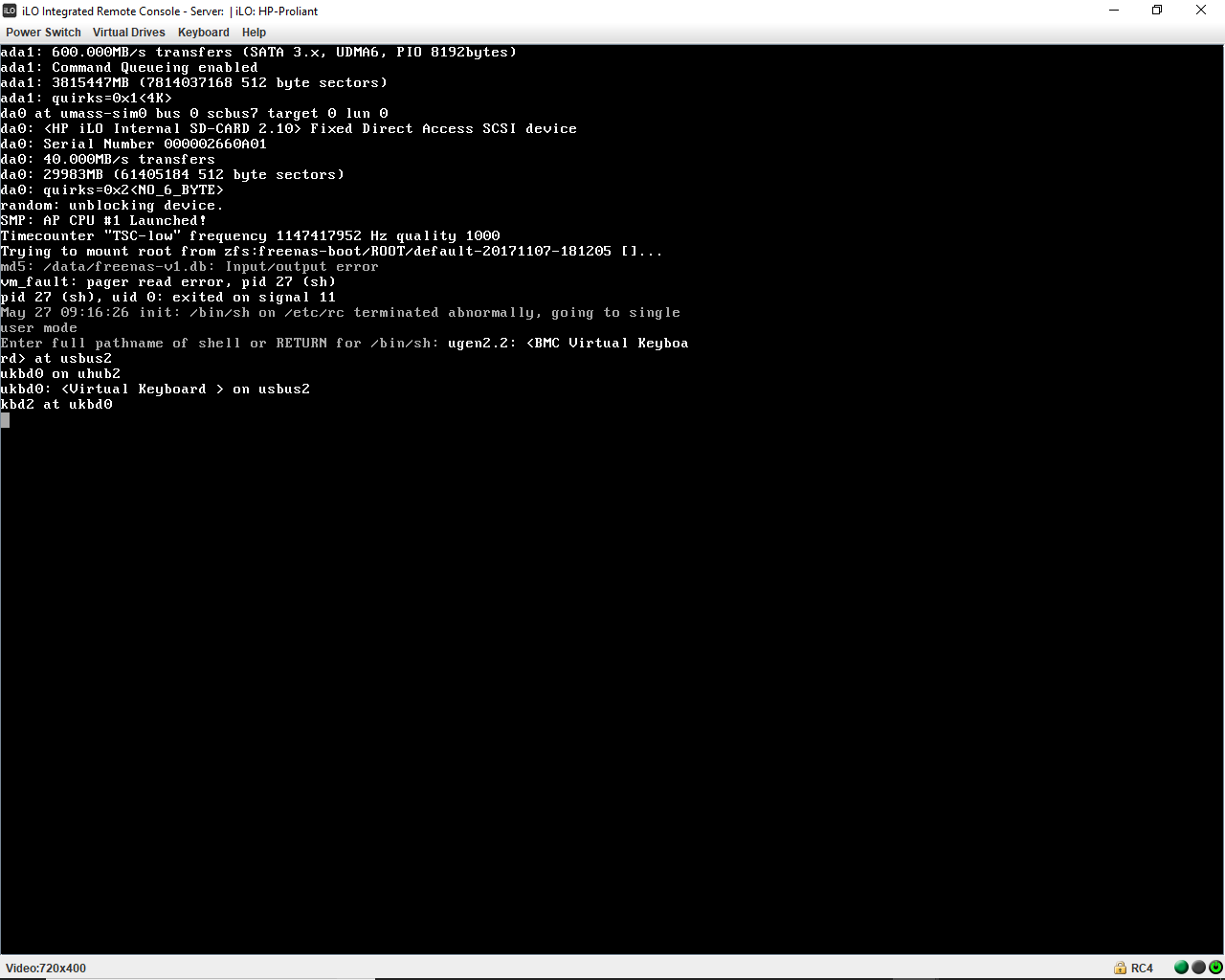

Dear all, first of all my apologies if this question has been already answered before, I am new here.
I have an HP proliant 8th gen server with a freenas as OS. Up to now (more than a yerar working without any issue) everything went smooth, but suddenly from yesterday I am not able to connect to my server any longer.
Using the iLO tool I have captured an screen (below) which I think might give a clue of what is going on. I refer to the following lines:
md5: /data/freenas-v1.db: Input/output error
init: /bin/sh on etc/rc terminated abnormally going to single user mode
Enter full pathname of shell or return for bin/sh:
Can anybody help me to solve this?
Will I loose al my data if I reinstall freenas again from zero?
Thanks and best regadrs

Sounds like your boot device is pining for the fjords.
Why do people keep asking this question? What piece of crap software exists out there that behaves like this?

Yes, you need to install FreeNAS to new boot media and upload your config.
