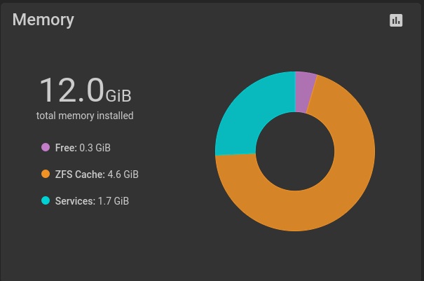

GeneL
Oct 8, 2020
9
First I have not installed any guest agent or balloon driver. Whatever is happening should not be due to something I loaded, because this is a pretty straight forward installation of FreeNAS, that for now I have tried to keep as minimal as possible. I went to get a listing from pkg but the list is 377 entries, so not now. I can up the memory to a minimum of 8GB and probably will.
However, consider the image below is from the dashboard, obviously FreeNAS has 12 GIB configured but is using only 6.6 GiB. Which is just ever so slightly above what I configured as the "minimum memory". If I had not sat and looked at this carefully I would never know that there was some limit on how much memory FreeNAS would keep in use. It always uses what ever I configure at the minimum. I really wanted to configure FreeNAS with 16GiB max and 4 GiB min so it could just use what it wanted, but right now it looks like it will just use the minimum.
So, if you guys think I should up the minimum to 8 GiB I will certainly do that. But I still don't understand the behavior. I'm kind of loath to experiment with this server. I think I will spin up another test machine to torture and see if I can quantify the behavior. It'll probably take a couple of days. I'll get back to you.
Gene
NickF
Jun 12, 2014
145
I don't want to be that guy...but I am confused. Virtualizing FreeNAS on ESXI makes sense in some specific applications. But virtualizing it on Proxmox makes very little sense, since Proxmox natively has ZFS baked into it. Why not use the native ZFS in the hypervisor?
IXSystems is literally taking the concept of Proxmox and building TrueNAS SCALE with that idea...
As for the memory, of course it will use the minimum. ZFS is always going to try to use all of your unused memory...
jgreco
Resident Grinch
May 29, 2011
16,550
Your PC has a filesystem built into it. Why don't you just store your files on that instead of on FreeNAS? :smile:
A hypervisor and a NAS are two very different things. A hypervisor does not specialize in file storage and can't easily handle serving up CIFS, NFS, AFP, Active Directory, replication, etc.
