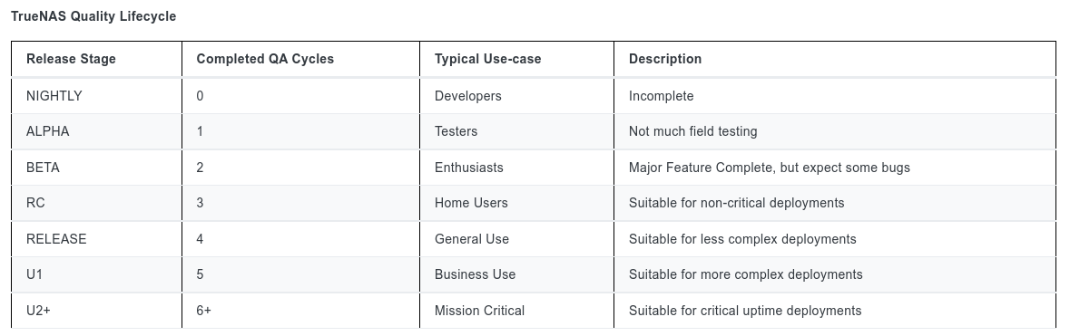

At the end, if you look at any of their Release Note, you could see we are a bunch of Enthusiasts dwelling to expect and report bugs.
