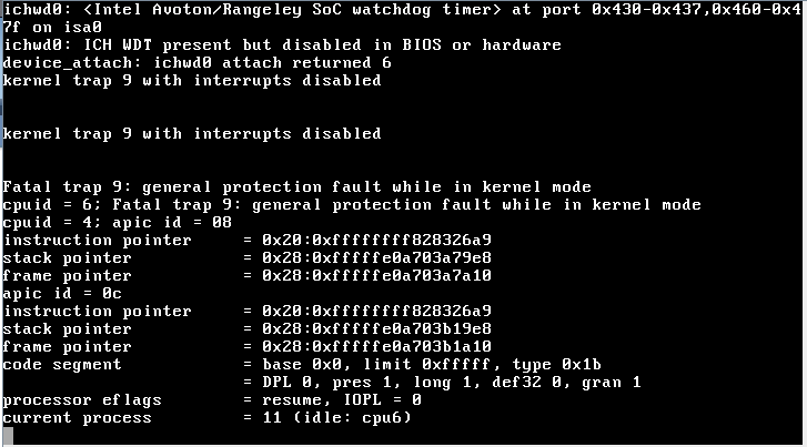

Just came back home from a long hospital stay to find my freenas crashed with the following error: Please see attached file)
Any ideas?

What are you running, 11.1-U5 ? I can state for a fact that I will not update to U5, too many people having issues with it.
hopefully this isn't the watchdog timer issue where the motherboards go bad. I don't recall the specific error messages for that issue, you may want to look into it. If that is the problem, iXsystems may help fix it.

I am going to install a secondary USB with 11.1 older version and see what happens

11.1-U4 is pretty safe to use. And if you did run into the motherboard issue, contact iXsystems about it as it's a well known problem and they have been replacing motherboard even well beyond the warranty period.
