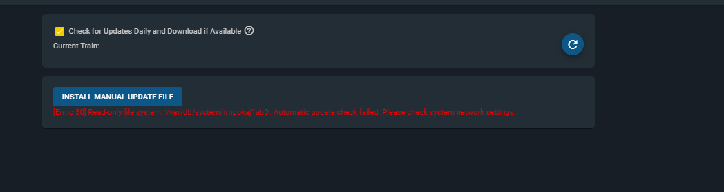

1. If I go to system->update and check for updates, it does not work. I get the error message the following error message
[Errno 30] Read-only file system: '/var/db/system/tmpdegc5vcz': Automatic update check failed. Please check system network settings.

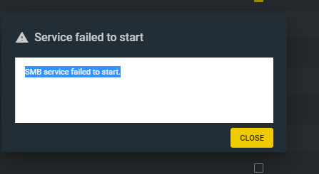

2. My SMB service is broken. I tried turning off the service and turning it back on. It does not turn back on. Instead, I get the error message "SMB service failed to start."
If I make 'read only = off' again for Tank1, both of these problems go away. So it looks like there is some residual dependency on Tank1. I went through the settings to find that dependency and change it to Tank2. But I'm not able to find it. Could someone please help me find the dependency?
Where's your system dataset?
