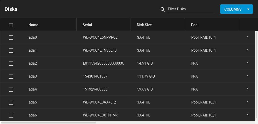

Hi all, I just recently purchased a used FreeNAS Mini with 4x 4TB HDDs, as well as the optional L2ARC and ZIL SSDs installed. In my particular case, I chose to create two striped VDEVs and then mirror the two VDEVs (basically RAID10) as it was more practical for my usage, so now I have some extra SSD storage and I'm not quite sure what to do with it.
My first question: what is ada2? It looks like it might be the disk the OS would be installed on but I'm not sure.
Second question: how should I arrange ada3 and ada4? I wish they were the same size, then I would just create a striped VDEV and use them for VM/Jail/Plugin storage, but alas they are not, and I don't really want to waste 50GB on ada3 by striping it with the smaller ada4.
I'd appreciate your suggestions, TrueNAS is new and exciting for me; I just wanted to get a better NAS, and what I got far exceeds my expectations, so much that I'm not 100% sure what I'm doing to do with it all just yet!

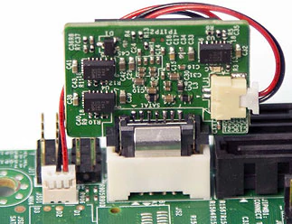

ADA2 is likely a 16GB SATADOM if your Mini was confectioned the way my Mini XL was. Look for a small circuit board sticking out of a SATA connector on your motherboard. It should also feature with a tiny 5VDC power connector and two thin wires going to a IDE power connector if it was like my ASROCK C2750D4I board. See below (image courtesy of SuperMicro)
As for 2), you could do some command line magic and partition the larger drive, then combine the partition with the extant smaller drive to create the mirrored striped VDEV you seek. Then use the other partition to create a mirrored boot pool with the SATADOM drive? or perhaps a L2ARC? Understand that none of this is supported by the GUI, and hence your mileage may vary tremendously.

I would recommend that you first clearly identify what the three drives really are but opening a Shell and entering the following command: smartctl -i /dev/ada2 and note the drive make and model, then repeat it for ada3 and ada4. Report the data to the thread here.
truenas% sudo smartctl -i /dev/ada2
smartctl 7.1 2019-12-30 r5022 [FreeBSD 12.2-RELEASE-p3 amd64] (local build)
Copyright (C) 2002-19, Bruce Allen, Christian Franke, www.smartmontools.org
Model Family:     Apacer SDM5/5A/5A-M Series SSD Module
Device Model:     16GB SATA Flash Drive
Serial Number:    E011534200000000003C
Firmware Version: SFDE001A
User Capacity:    16,013,942,784 bytes [16.0 GB]
Sector Sizes:     512 bytes logical, 4096 bytes physical
Rotation Rate:    Solid State Device
Form Factor:      2.5 inches
Device is:        In smartctl database [for details use: -P show]
ATA Version is:   ACS-2 (minor revision not indicated)
SATA Version is:  SATA 3.0, 6.0 Gb/s (current: 6.0 Gb/s)
Local Time is:    Tue Feb 23 13:17:46 2021 EST
SMART support is: Enabled
truenas% sudo smartctl -i /dev/ada3
Model Family:     Marvell based SanDisk SSDs
Device Model:     SanDisk SDSSDHII120G
Serial Number:    154301401307
LU WWN Device Id: 5 001b44 ef8a984db
Firmware Version: X31200RL
User Capacity:    120,034,123,776 bytes [120 GB]
ATA Version is:   ACS-2 T13/2015-D revision 3
SATA Version is:  SATA 3.2, 6.0 Gb/s (current: 6.0 Gb/s)
Local Time is:    Tue Feb 23 13:17:58 2021 EST
truenas% sudo smartctl -i /dev/ada4
Device Model:     SanDisk SD6SB1M064G1022I
Serial Number:    151929400303
LU WWN Device Id: 5 001b44 e6b47a7ef
Firmware Version: X231600
User Capacity:    64,023,257,088 bytes [64.0 GB]
Form Factor:      Unknown (0x000a)
ATA Version is:   ATA8-ACS T13/1699-D revision 6
Local Time is:    Tue Feb 23 13:18:00 2021 EST

Ahh, so the SATADOM is the system image repository! Makes sense, I'll leave that alone.
Funny you should mention the quality of the SSDs; they're actually labeled as L2ARC and ZIL. I just opened up the case and looked at the motherboard headers:
SATAIII_M1: SATADOM
SATAIII_M2: SSD labeled L2ARC (FreeNAS printed label)
SATAIII_M3: SSD labeled ZIL (FreeNAS printed label)
Based on the /dev numbering and knowing that /dev/ada2 is the SATADOM, it would seem that /dev/ada3 was originally used as the L2ARC (120GB L2ARC for 8TB of storage seems a little crazy though), and /dev/ada4 was originally the ZIL.
I've done a little more reading, and it doesn't seem like a terrible idea to at least have an L2ARC, maybe I can take the device originally designated as the ZIL for a different pool for something else then?
