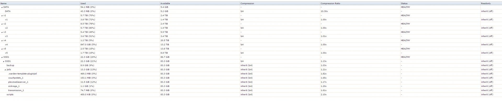

good question. I don't know. if moving data pool also moves the swap then yes. (I didn't think that this will be the case I thought the swap will be created on storage pools) how can I check is swaps are also on my data usb? I have five storage pools (screen shot attached) I use my 120GB SSD for jails and backup so I could move my data pool to it too. Would that be a good move?

15,504
Does that mean the swap is on the USBs too?
No, swap isn't on the .system dataset; it's on the 2 GB (by default) partitions created at the beginning of each disk you use in your storage pool.

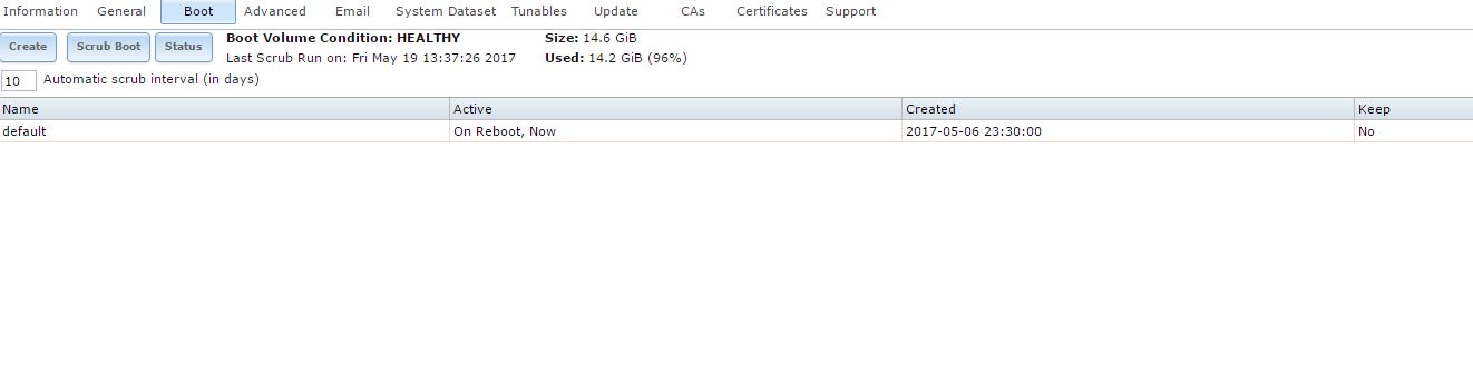

thanks Dan. I still don't know why I get the warning about capacity of my system (screenshot attached)

TomasNZ78
Apr 19, 2016
25
ok, I have installed ver 11 from scratch and now my system takes 5% of the 16GB capacity. It was some odd glitch that happen to me on the old one.
