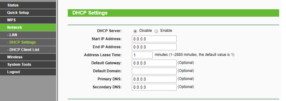

This sounds like a simple setup issue with respect to your AP's. Off the top on my head the first thing I'm check is to make sure you only have one DHCP server running. So if you have DHCP turned on in the AP's, turn it off. Your Router should be doing DHCP already (in a normal configuration).

the asus router is dhcp for sure - freenas is not running dhcp although i was thinking of using that instead. dhcp on the aps is off for sure.

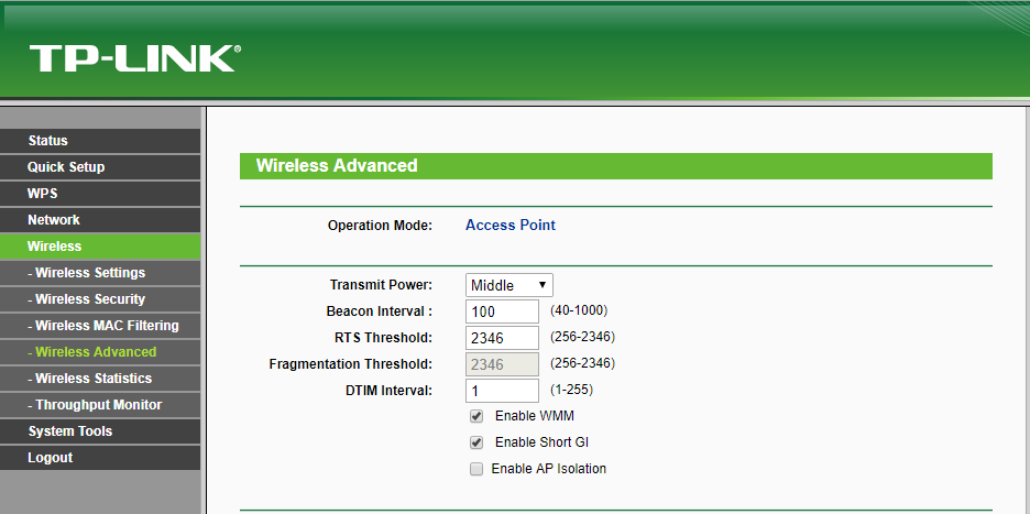

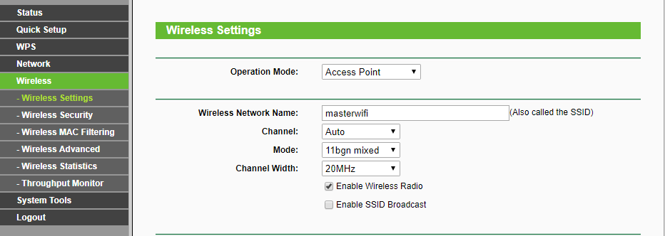

here is one ap details also noting the plex port is 32400 its all in house so i have no open ports on the router.

5. Try to disable Short GI.
6. Try to use a higher transmit power level.

5. Try to disable Short GI. ( I will turn that off)
6. Try to use a higher transmit power level. (I had turned the power down by default its on hi) thinking that was burning it up and causing it to fail over time. granted i am not trying to reach this ap from the other side of the place if i am in that room i will connect to that access point.
