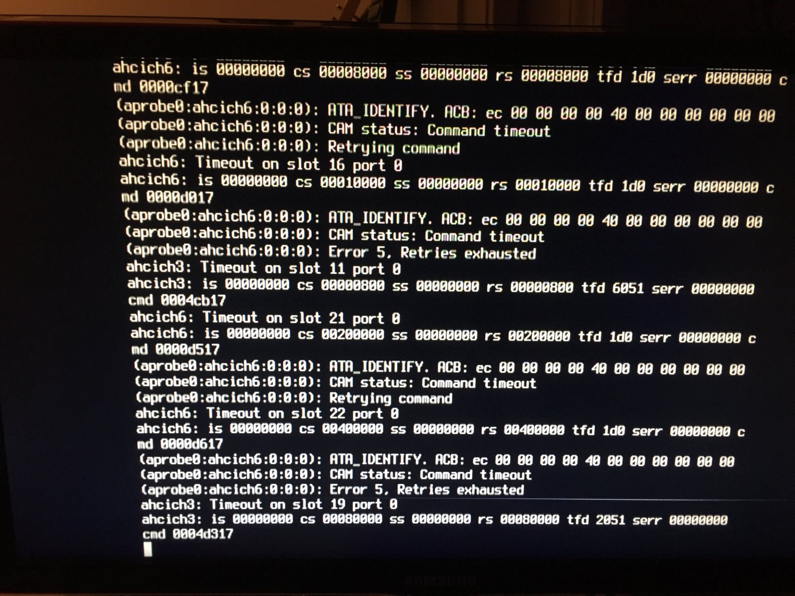

I realize that the board and RAM are not optimal for freenas, but the board had 10 SATA ports and I was in a time crunch and it was quickly available. I was booting my original freenas setup from an old OCZ USB stick, and it booted back up quickly, with no errors with the new hardware, but the onboard NICs were not recognizes in freenas 8. So, I grabbed a larger 16GB Sandisk Cruzer USB stick and installed FreeNAS 9.10-STABLE from a DVD. Now, the problem is, FreeNAS DOES boot up, but it takes roughly 20-25 minutes to do so and gets CAM Status errors during the whole process. Screenshot below.
I tried a couple of different USB sticks and even a Western Digital USB drive, but nothing changes. 20 minute boot time with those errors. But, once it boots up, everything works fine. I was able to import my old volumes and set up a Plex jail no problem. Transfer rates are excellent. I am currently booting freenas from the WD 120gb USB drive. So, is there anything I can do or should I just accept the massive boot time and go with it? I mean, things seem to be great once it boots up, but those errors make me question if it's truly stable or not. I appreciate any suggestions.
I have a Z86 Extreme6 (my desktop, not my storage server), it has 6 SATA ports controlled by the PCH
and 4 SATA ports controlled by an ASMedia ASM1061 controller (completely separate chip-set).
When you have a total of 8 drives, I'm assuming at least two of them are gonna be hooked to the
OTHER controller. FreeNAS sometimes does not like this situation and this could be the cause.
If you care about your data, get your pool on to recommended hardware.
IMHO this statement above should read "totally inadequate" instead of "not optimal". Get your data backed up
soonest. I'm not kidding...

I realize that the Z97 has 2 SATA controllers, and 2 of the drives are on a different controller, but I ran Freenas 8 like this on a different board for 2+ years with no issues. Oh well. Getting different hardware at this point in time is just not feasible. I suppose I could look for a supported controller card that would support all the drives.

Appreciate the suggestions Joe. It appears like I was able to get rid of the errors and get a clean boot. What finally did it was unplugging my internal SATA dvdrom. Once I did that, freenas boots in about 1.5 minutes with no errors. Strange.
