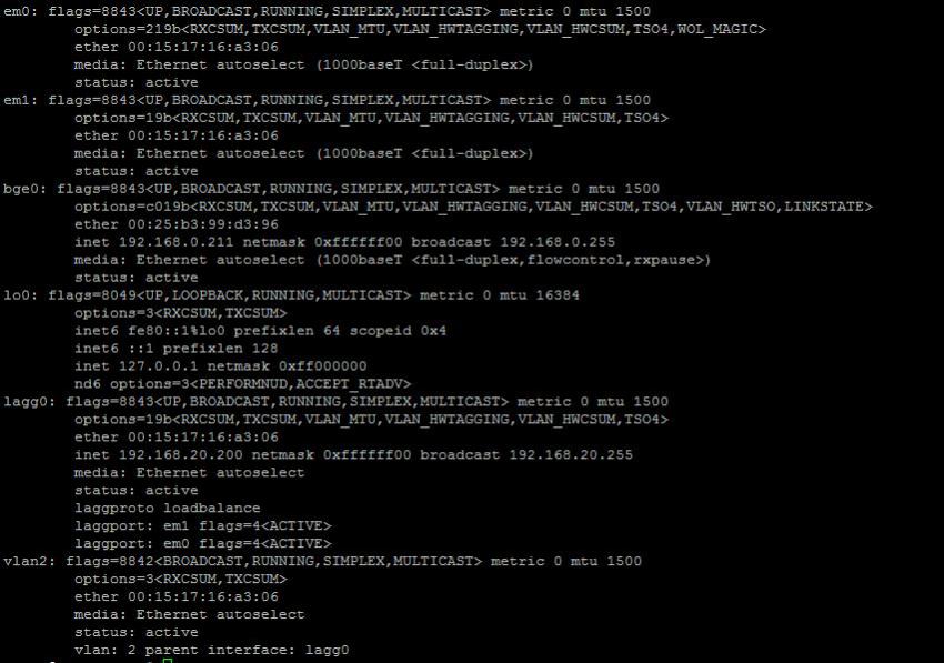

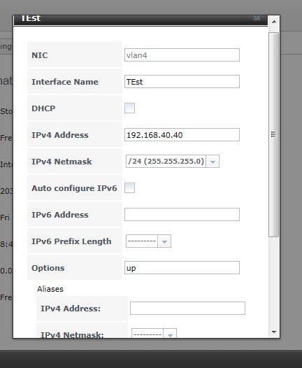

Hey Everyone
i am new Freenas (but not to linux)
but i am running into a problem, and i am asking for help
i am recently just installed freenas onto a spare HP ML110 G5 and i have put in a dual Intel Pro 1000PT Nic
i am trying to configure a Lagg interface ( load balance or LACP ) and i want to put it on to a seperate vlan, now my vlan configuration on my cisco switches and routers are working correctly but everytime i configure a lagg interface and add it to the vlan it doesnt work ( i cant ping anything on that vlan subnet from the freenas box and i cant ping the freenas lagg interface)
can someone help
Below are some screenshots of my configuration

So, you configured your switch to have an LACP interface between 2 ports, and made those 2 ports trunk ports?

Yea i did that
i even went as far as removing the LACP config and just trying to get one of the the interfaces to work but unfortunately i can even get a single nic to access the vlan

Yea i have been trying to work it out
at the moment i am trying to just get 1 nic to work, but after i configure the vlan and ip settings in the web interface it still doesnt work
i have been reading that people have more success when they manually configure the vlan adaptor with a Ip address but i cant locate the file those settings are stored in, they say the /etc/rc.conf file has it but i open it and it does not
any ideas

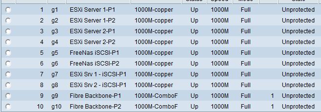

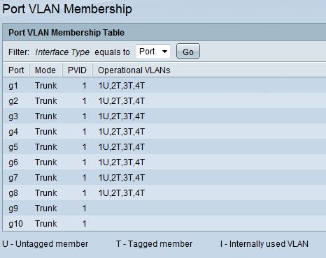

Yea my vlan config is working, cause other devices on the same vlans are working EG: the esxi servers iSCSI nics
( Switch Config in Screen Shots )
I have gone back to basics and just trying to get one network card to work on the VLAN
but alas no go, i have now gotten to Freenas to see the vlan config as a Interface, since i tried configuring it threw the console but i dont get why its not working, is there anything that we have to add to the freenas startup files ( loader.conf for example)
The network card i am using does support vlans cause i have the same cards in my ESXi Servers, and the Intel 1000Pro GT dual are supported by freenas, this is just confusing me because from what i have been told this shouldnt be that hard to configure
