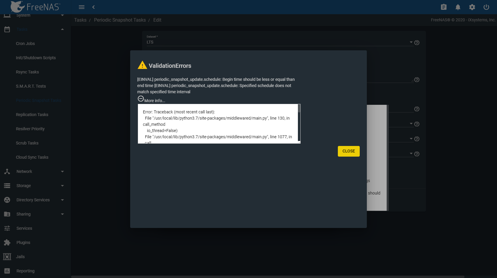

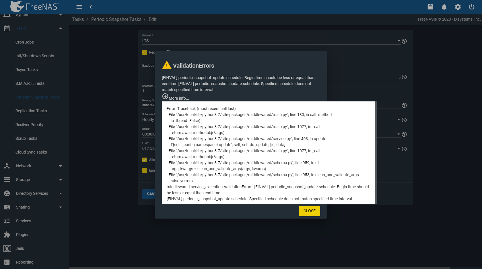

@anodos Did 11.3 remove the ability for the snapshot creation start time to be later than the end time? I often work late and do hourly snapshots, so I have the snapshot start time set to 8 AM and end time at 1.15 AM. After the update, my previous task still works, but seems that if I try to change anything in the task or try to create a new one with the same times, I get a Validation error and the Python script crashes. Also the error window itself seems wonky. The error traceback is out of the window and I get 2 of them after pressing "More info".
Can you "report a bug" for this type of issue. We'd like to resolve ASAP.

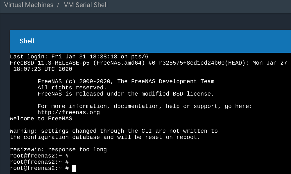

Nice looking update!!
Using serial interace for VM, launches the shell but cu -l /dev/nmdmXX doesn't automatically connect to the interface and generates a resizewin error.
However, you can then manually connect by re-issuing the cu command.
