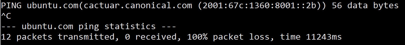

Hello good people, I installed Ubuntu server 18.04.2 in VM on FreeNAS-11.2-U3 (my first and fresh FreeNAS install) and it has no internet connection from inside. So I probably need to do something with network settings? I am really lame with network things, I hoped that this would all work automatically :(
Is there a step by step tutorial or someone who could help me with this please?
Thanks

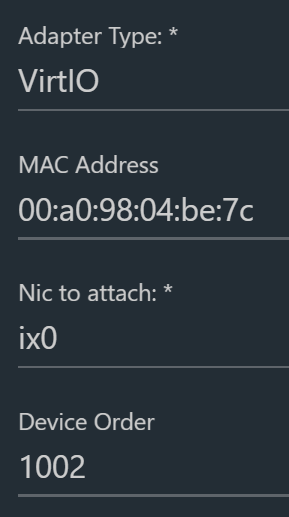

My VM has one NIC in devices that looks like this:
- I tried to change the adapter type to the "Intel e82545 (e1000)" but no change.

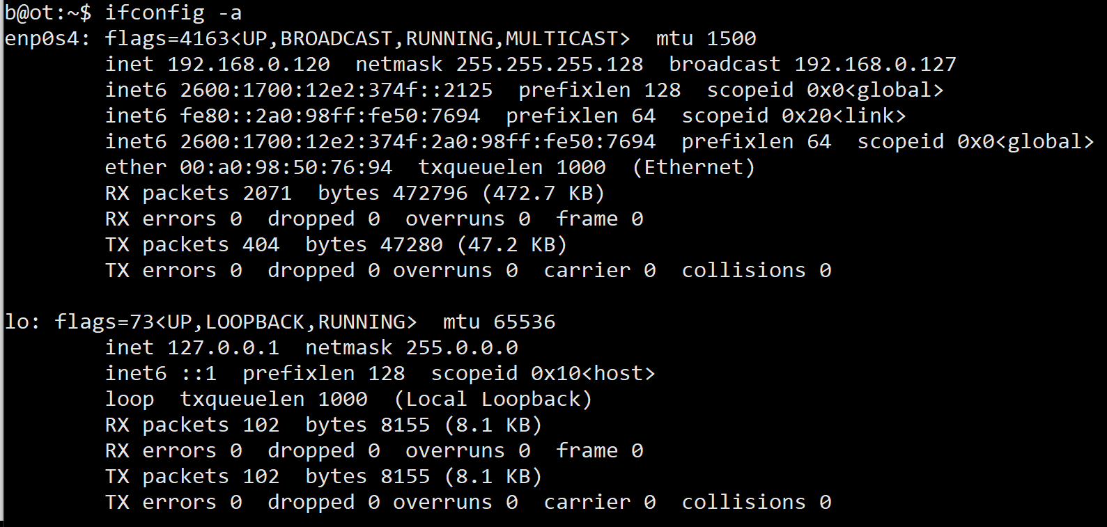

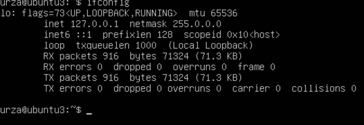

From Ubuntu (using VNC) it if I run ifconfig:
KrisBee
Mar 20, 2017
1,288

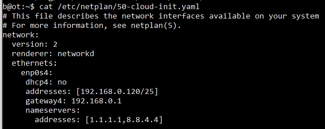

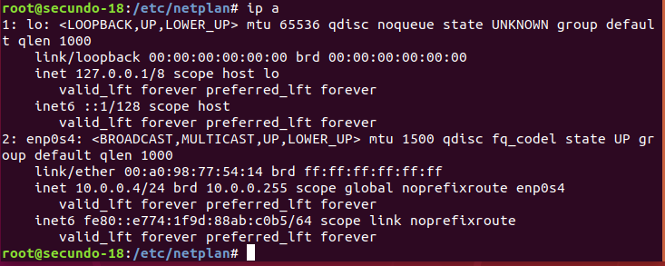

Use ip a in your Ubuntu VM, and it will probably show something like this:
What ever connection you set up during the install (dhcp or static IP), it has been lost on the first boot. This happens because to boot the VM you have to remove the CDROM device, and when you remove the cdrom device the bhyve slot used by the NIC device changes. Inside the VM this changes the "predictable network interface name" from say enp0s5 to enp0s4.
You will need to re-configure the network inside the VM, for example:
In this case, just edit appropriate netplan file to change the "predictable network interface name" to enp0s4 and restart the network , for example using a combo of sed & netplan apply:

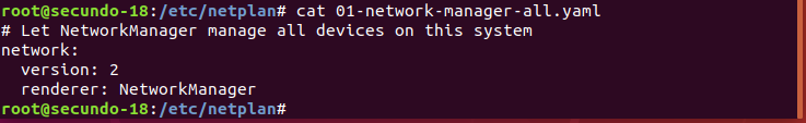

My file is named different from @KrisBee so I do command cat 01-network-manager-all.yaml on my file in that folder and I get:
This kind of leaves me at a loss because I'm not sure how to use the commands sed and net apply when my file isn't showing any of those details or settings i can reconfigure. I did try to ADD those lines with nano -w 01-network-manager-all.yaml but it did not work for me.

@MauricioU Servcer Did you install server of desktop Ubuntu in your VM? It lloks like a desktp install to me, in which case configure the VM network card from the GUI.

Figured it out.
I have 2 nics in my system, a 1 gb nic with 2 ports and a 10 gb nic with 2 ports. The nic device for the VM was set to one of the 10 gb ports. Just to try things I changed it to one of the 1 gb ports and it all of a sudden worked.
However, the most confusing aspect of this is that the VM was ALWAYS set as one of the 10 gb ports. I know this sounds wrong but I know this because I messed with it a long time ago and it worked and I was confused as I didn't think it'd work but it did which is why I didn't think changing that would make a difference. Furthermore, when I installed another VM just to test this it was ALSO set to the 10 gb port by default and it worked just fine until I restarted the entire server.
So I'm a bit confused but it's working now.
Thanks for all the help! And if anyone runs into this issue with the Desktop version of Ubuntu and you have two nics installed, give it a shot! lol

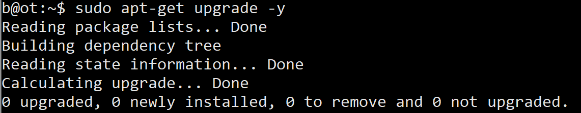

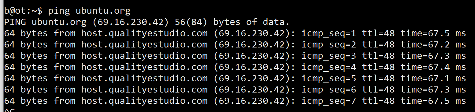

Beerman81
Apr 19, 2020
I followed the instructions in your post (THANKS), and the VM is clearly connected to the internet, because i can update it and ping IPv4 addresses. However, something on the IPv6 side is broken, because when i ping one of those it times out. Before i deploy this VM into action, I would like to fix this or disable IPv6 entirely.
