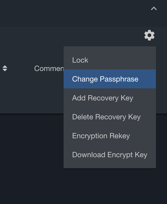

Hmm maybe a new GELI encryption key was generated? That would explain the missing passphrase. Do you have a backup of the old key file? If so could you compare the old and current one?
So, since I don't have a great program to compare them (or the knowledge to use GREP like this), I can only say that of the multiple keyfiles I have, every key I have is different based on opening the 64-byte file in BBEdit and comparing them visually. One GELI file is from September 26, Dec 6 (post 11.2 upgrade), and today (added the L2ARC SSD a few days ago).
I will reboot at some point today to see if the pass-phrase "took" (the UI suggests a pass-phrase was successfully set)

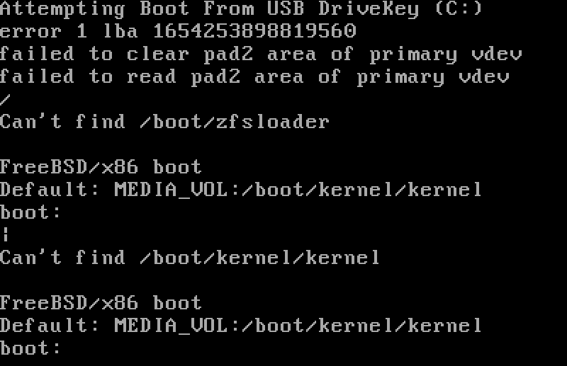

Having upgraded ealier form 11.1-U6 --> 11.2.RC3 all went well with no problem.
Today I tried upgrading 11.2.RC3 --> 11.2-REL and the boot-loader got damaged
I do not have a config backup.
I run FreeNAS on a HP Microserver Gen8, which I understand does not support UEFI
this is what I have tried so far ...
Try #1
1. Using install ISO on usb key, upgraded to 11.1-U6 by selecting reformat boot, BIOS boot
2. Freenas DB was upgraded with errors
3. booted to FreeNAS, all jails and VMs booted correctly
4. System Menu (legacy) throws errors and cannot use at all
5. System Menu (Angular) works with no errors; can select upgrade menu but a spining dialog never goes awat
Try #2
1. Using install ISO on usb key, upgraded to 11.2-REL by selecting reformat boot, *UEFI* boot
2. Freenas DB was upgraded with *no* errors
3. cannot boot, getting boot error "cannot boot from data partition"
Try #3
1. Using install ISO on usb key, then upgraded to 11.2-REL by selecting reformat boot, *BIOS* boot

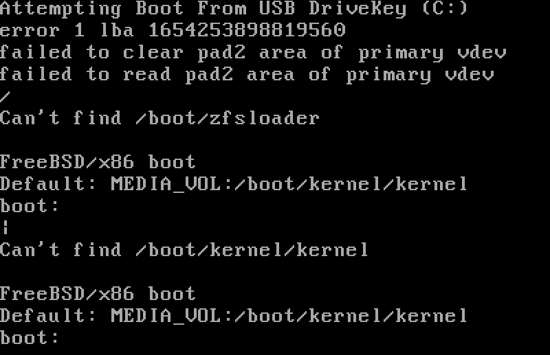

3. cannot boot, getting again the below screen - hence it is unlikely to be bad sector on the boot device
Try #4
1. Using install ISO on usb key, then do a fresh install for 11.2-REL by selecting reformat boot, *BIOS* boot
2. cannot boot, getting again the below screen - hence it is unlikely to be bad sector on the boot device
Any advise on how to recover the bootloader would be welcomed.

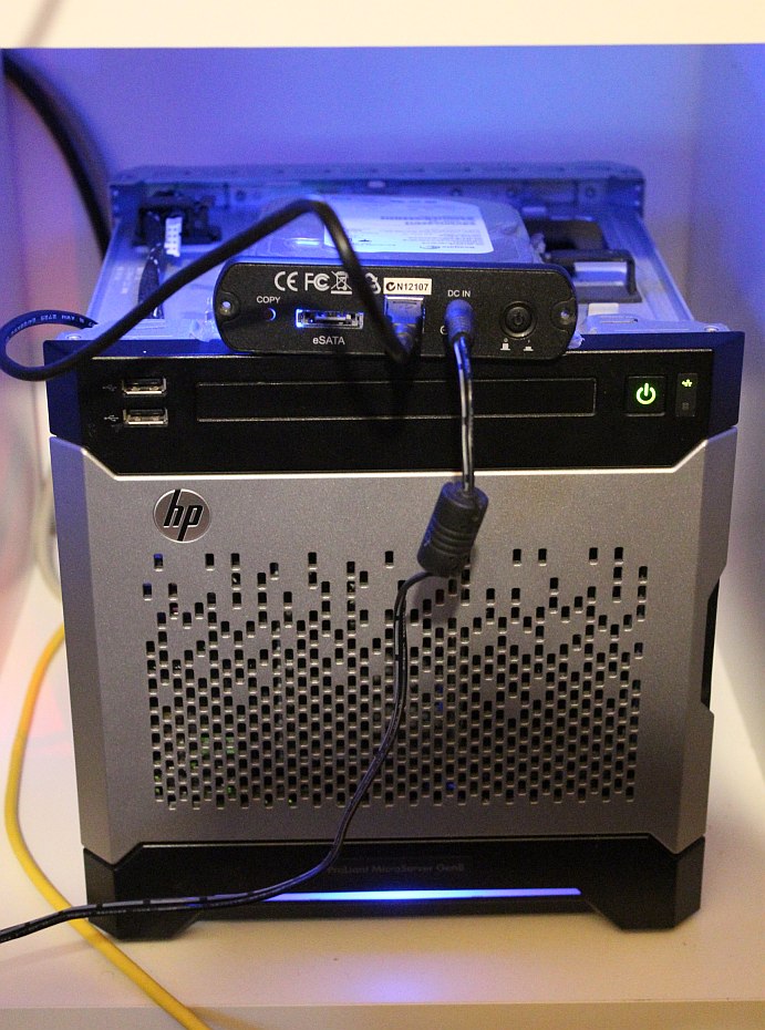

If you feel like doing a little test… hook up an external 2.5 or 3.5 USB HDD to an usb port and do a test install from ISO!
None of my problems did show up and install time was down to ~4m.
It always felt like I would waste that 5th Sata Port if I was to use it for boot.
If a usb stick fails — and they do — it's a quick fix, as there are sticks to be found in almost any office drawer ;-)
And the System Dataset on the the pool, you got an up to date config to load.
USB2 speed of ~30-40MBps is plenty, spinning hdds are durable and I finally have a use case for all the 2.5 500GB drives I pulled out of notebooks for newer SSDs.
