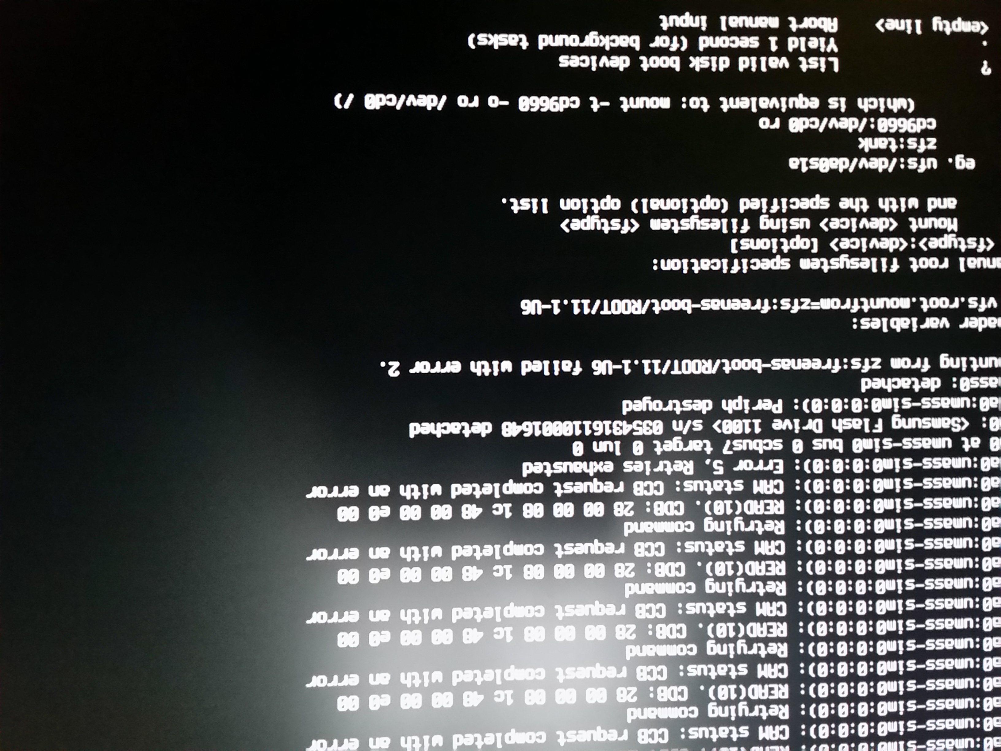

So far, my Freenas system started with two USB flash drives operating in mirroring mode. From time to time, one of the pendrives required resilvering as the system removed it. It helped. Today I was unable to run the system in general. After connecting the monitor I get a ZFS Boot 11.1.U6 error - error 5. Please help me bring the system back to life, without losing data from hard drives (5x 4TB)

you can easily reinstall the operating system to your usb drives and you will not touch the data drives. You can import them after the reinstall is completed.

I was today recovery my system but I was have a permanent problem with adds second (identical) usb drive to boot.
Non stop i see on external monitor errors (write, read) and my drive is permanently degraded and removed.
I tested (extendly) my usb drives (two identical) and not have any errors !
I can't attaché my second drive to existing boot usb drive.
Many times ago we both working.
Maybe is a problem with build 11-1u6 ?
Ps. I use for booting device the two identical 64GB Samsung USB 3.0 drives. Maybe is a too big storage ?

It's a bad idea to use USB 3.0 drives for booting. Take it to hot on your constant use. You should use USB 2.0 drives and they only need to be 16 gig
