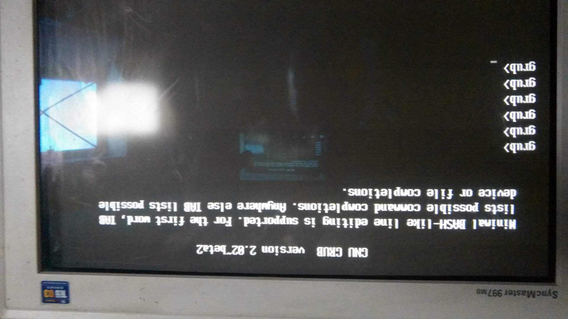

Please help, I made an upgrade from RC3 - RC4, but then the system did not run and shows the message on the screen.
On another PC system
HW HP Proliant ML 330 G6, 12GB ECC RAM, Proc 2,4 GHz, system flash 16 GB, data 4*1 TB WD Red
Reinstall from scratch, upload your config backup and pay for my medical bills for the neck injury I sustained trying to read your screenshot.

Just lay your SurfacePro flat and turn it 180 degrees. :smile:
... pay for my medical bills for the neck injury I sustained trying to read your screenshot.
