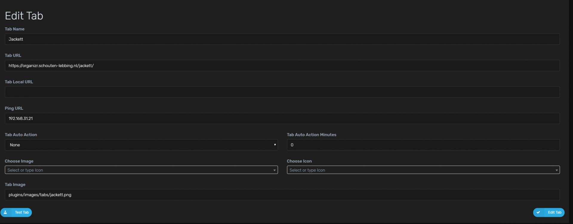

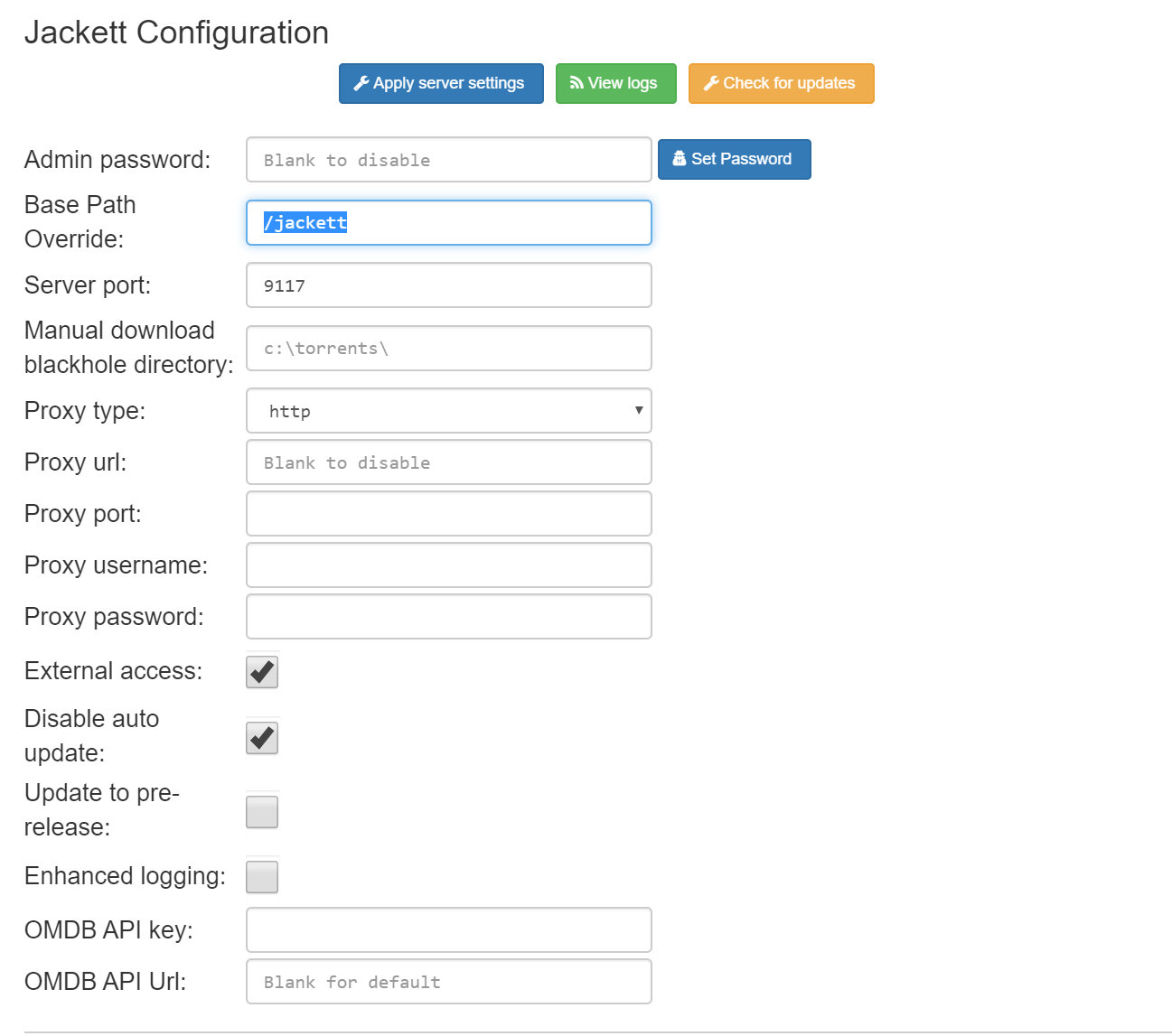

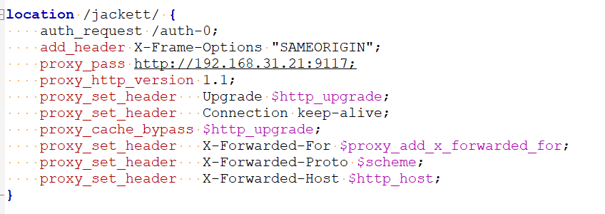

The redirection of the recent Jackett update (v0.13.483 or v0.13.467) breaks the page in Organizr (301 error, infinite redirect). Anyone got the same issue?
ornias
Mar 6, 2020
1,458
Nope, attached is my config...

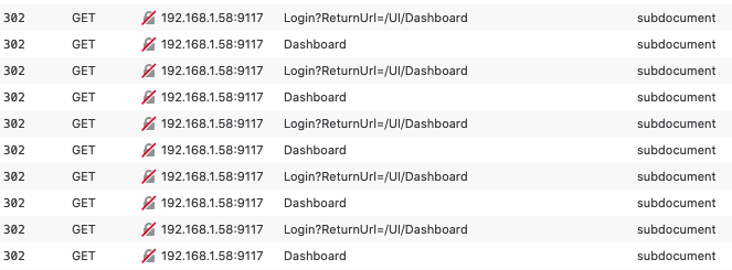

The thing is if I go directly to http://{jail-ip}:9117/ in the browser I have no problem connecting to Jackett. If I use the same URL in Organizr I get the redirect loop error. My guess that it's related to recent Jackett update is because when I rolled back to the version about 3 weeks old I have no problem accessing Jackett in Organizr. Then I forgot to turn off auto-update in Jackett and once it's updated to latest version I am back with redirect loop in Organizr.
The attached image shows the redirect traffic. I also checked the storage/cookies and I can see cookies from Jackett server when it's loaded successfully (when accessed directly on through ip). Oddly enough, I was able to access Jackett on my laptop using Chrome since this morning and I went on delete the cookies from Jackett, and it's back too redirect loop again.
Still trying to wrap my head around this. Honestly it's no big deal and I can just open a new window from Organizr, but it's BUGging me.

The thing is if I go directly to http://{jail-IP}:9117/ in the browser I have no problem connecting to Jackett. If I use the same URL in Organizr I get the redirect loop error.
Actually, something just struck me...
I had something like the same, till I moved jacket up a level...
So instead of http://{jail-IP}:9117/
I moved mine to http://{jail-IP}:9117/jackett and that fixed it for me I think :)
