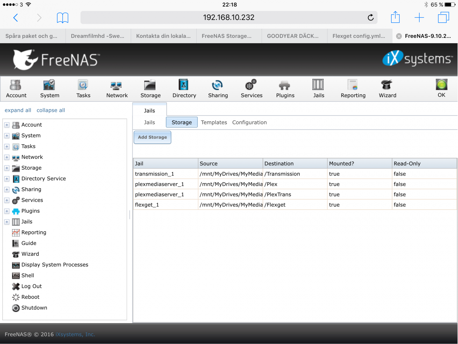

Here, I know this is plex, but under jails > storage find your storage and see if 'mounted' is checked.
Also, make sure source and destination are configured properly as per your setup.
Tauq
Jul 26, 2015
27
It wasn't created, but I created it. But it still says that it can't find the confit.yml file. Have I missed a step or two after creating the storage?
