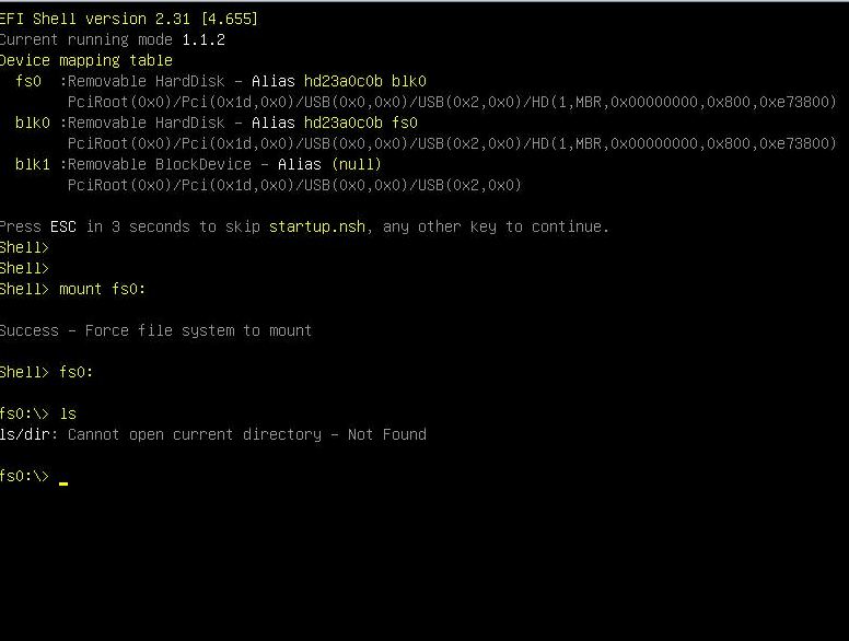

Quick question on the flashing.
I formatted to Fat32, copied the UEFI directory to the drive, booted to shell & it cant seem to see it.
I think it is me as i tried 3 different usb sticks.
Any ideas what I am doing wrong?
Thanks,
Rich

RichTJ99
Sep 12, 2013
384
Nope, just the one stick.
I even unplugged all the SATA hard drives.
Fat32 formatted at default windows 7 settings.
