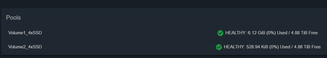

Now I have 2 pools. Do you recomend to put all disks to one pool and make 2 datasets - one for VM's and second for DB's?
To be honest I have 9 disks, 8 for storage and 1 for spare. What do you recommend:
RAID 1 (8 disks) + spare (1 disk) or RAIDZ2 (9 disks) without spare?
Yes, that's the suggestion - all of the disks in one pool, using mirrors ("RAID1" in your example) with one as a spare.
