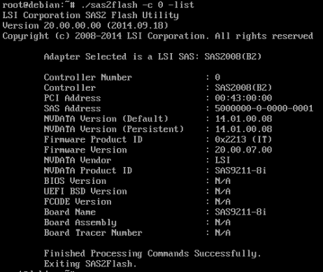

./sas2flash -c 0 -list shows this result. It seems some information is N/A. Is that normal? I lost my original SAS address, so I just made up one.I believe my H310 full size is working properly, but the system refuse to recognize it as a bootable device. I even successfully installed proxmox on the SSD that was connected to H310 while the back plane with the SAS drives connected to H310 mini. It means that both HBA can operate together.
