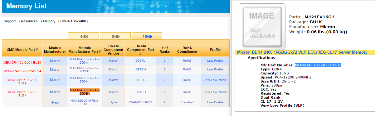

Right off the top of my head, that board is not compatible with registered DIMMs.
I'm a little confused by this because I matched the manufacturer number right off of Supermicro's site:
That indicates the Micron flash chip part number used on the DIMM, it's still a RDIMM not a UDIMM (unbuffered)
which is the type required by that board. I'll admit it's confusing sometimes:confused::confused::confused:
index.php
I'm fairly certain that whatever vendor you're looking at is wrong. The part number seems to be for UDIMMs.
