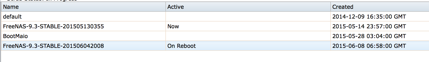

I didn't have many old boot environments left. But just started a scrub just in case...

Cleaned all but 2 boot environments and ran scrub and still no way to update, i.e. the same errors.
What's the correct procedure to migrate the current 8GB Boot USB Pen to a larger 16GB ??
