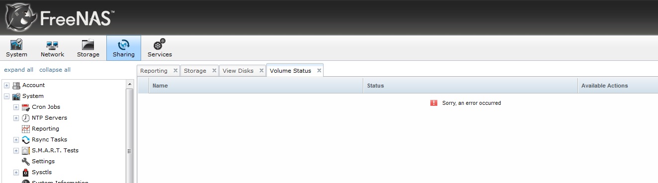

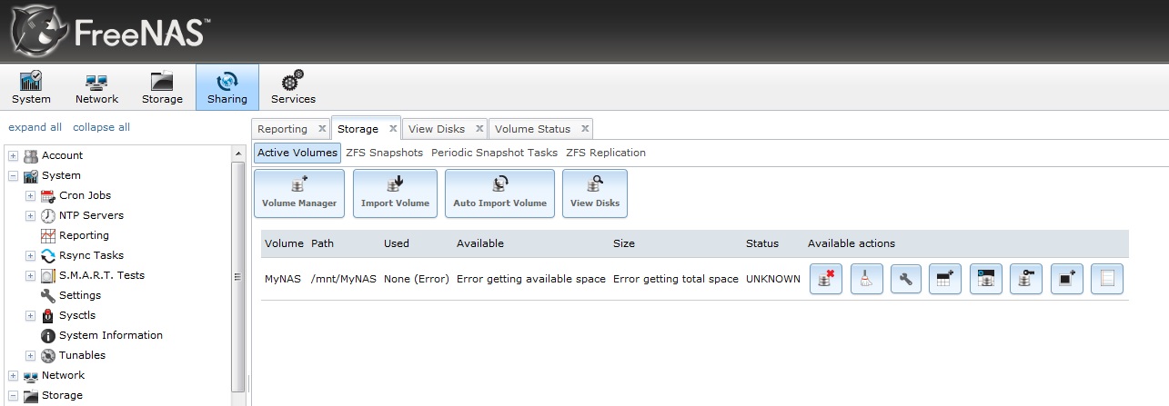

Hello all, I am running FreeNAS v8.2 on a Dell server. I have 4 HDs in RAID5. I had one HD fail and before I could replace it, a second drive went offline and I saw the PERC listed it as "foreign". I cleared the "foreign" and created a new virtual disk adding that formerly "foreign" listed disk to it. I replaced the failed drive with a new drive and created a virtual disk for that one as well. Dell PERC5 requires you create "virtual disks" for all drives.
Now I log into my GUI and I don't know what to do to bring back my volume online and get the new drive to resilver.
Please help?

Regardless of anything else that happened here; you're running a very old version of FreeNAS, you're using a RAID card, and you've lost two drives in a system that at some level was only set up to tolerate a single drive failure. Odds are very good your pool is damaged.
Longer version; you've introduced a layer of abstraction (hardware RAID) into the system, which means that unknown factors are impacting ZFS's ability to read your disk labels. Clearing/recreating the virtual disk may well have changed the label making it unreadable.
Given that you created a single vDisk for each device, it seems likely that you've used RAIDZ1 here rather than RAID5 on the PERC. Please confirm.

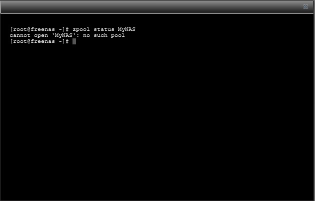

Open a shell prompt on your FreeNAS machine and type zpool status MyNAS and see if it recognizes the pool as mounted at all. It seems to be there.

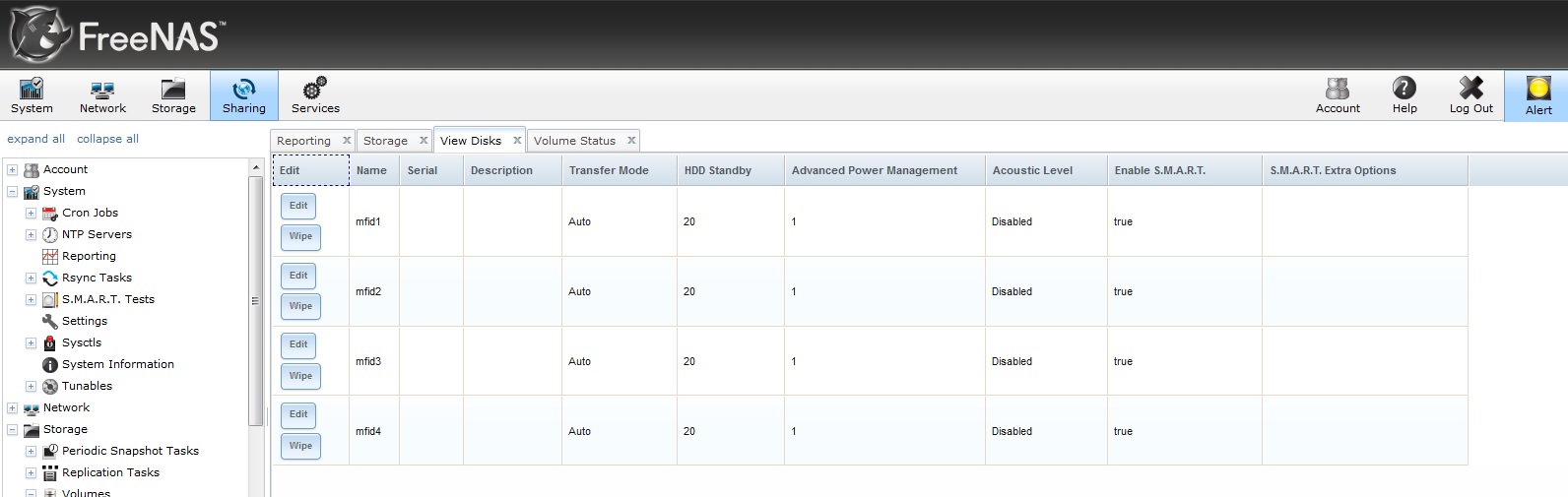

The PERC has each drive in separate virtual disk. AFAIK, the only way to bring a drive online server side is creating a virtual disk. The RAID5 is created by FreeNAS, not the PERC, otherwise FreeNAS would only see one drive, not four.
I get "no such pool" in shell.
I there a way to repair the volume and salvage some data if not all?
