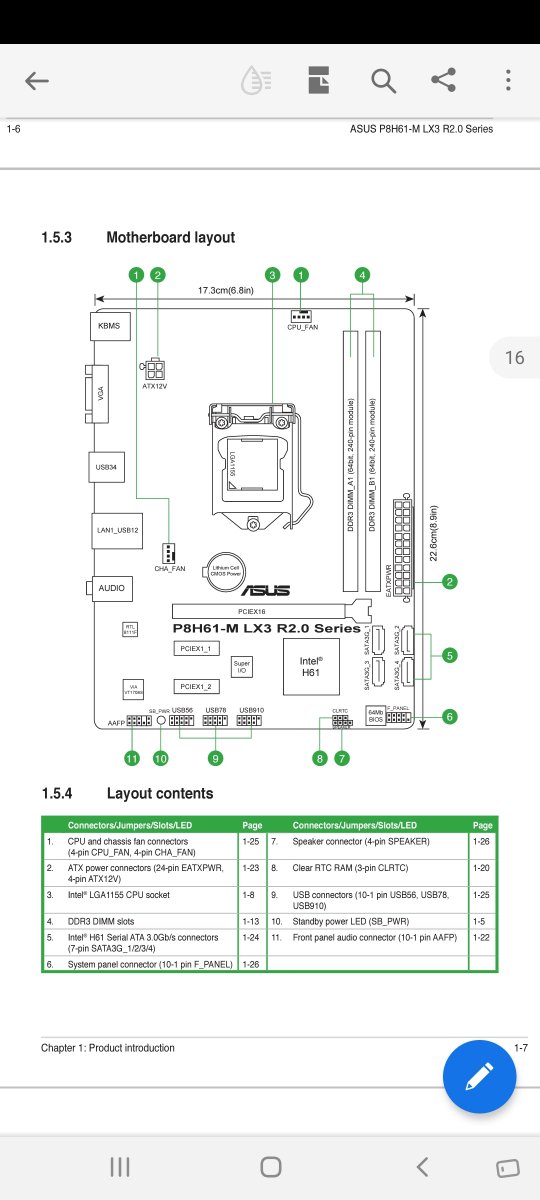

I have just been updating my NAS, cleaning out and so on, and was going to add two new drives but have run out of SATA ports.
What is the easiest option for a SATA controller Card. I have seen lost of threads about this but no real options or cards sujested and all require a but of work. Looking for just plug in and off we go if possible.
Was looking at this card.
Asus motherboard model attached.
Or if anyone has any other options that are know to work please let me know.
Would like 4 ports for further expansion if needed. Speed isn't an issue just storage.

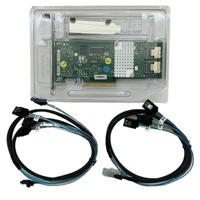

I found this, is this what you where talking about. It seems to be formatted in IT mode which I think is correct from the documentation, so this should be just plug in and off you go yeah.
Look at this on eBay
The cables provided look like you can have 8 drives is this true, just a dismissed speeds I assume.
Etorix
Dec 30, 2020
2,134
Yes, this is representative of what you want—but make sure the cables are short (≤50 cm), 70-100 cm cables are for SAS and may cause issues with SATA drives. No issue with speed… if the card has enough PCIe lanes: It's nominally x8.
