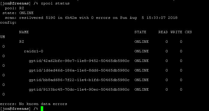

Hello All,
I am just looking for some quick clarification on the FreeNAS guide that covers expanding a 3 disk RAIDZ1 with a single VDEV (with a single disk).
I am fairly certain the system I am running was intially a 3 drive system that is now 4 drives, but the zpool status doesnt appear to be showing me 2 VDEVs, can someone confirm this? I dont exactly know what a 2 VDEV pool would look like. I just rebuilt the pool from a drive failure, and wanted to make sure i dont lose a drive that I cant recover from.
Here is the screenshot of my zpool status
Jon

The printout is a tree hierarchy. The line “raidz1-0” is your vdev. If you had more then one there would have been another “raidz1-1” “-2” “-3” etc.
You are correct that a pool have to be rebuilt to add another drive to an expiation raidz vdev.
Be advices, raidz1 is considered to be obsolete by the developers of OpenZFS due to the unacceptable high risk of a secondary bit error during a resilver. So if you are using raidz1 you need to be aware that the odds of having to restore a pool from backup high.

With a 4 disk pool, you can't have more than 1 VDEV of the type RAIDZ1 (since RAIDZ1 requires at minimum 3 disks... the smallest possible 2-VDEV RAIDZ1 pool is 6 disks).
Generally, the forum recommends (as @garm already mentioned) that if you care about your data, you won't be using RAIDZ1, but rather RAIDZ2 or 3.

I thought it was intially created as a 3 disk RAIDZ1 and then added a single disk in a RAID0 to it
If it was initially created as a three-disk RAIDZ1, then it was subsequently destroyed and recreated as a four-disk RAIDZ1. You don't have the striped disk you think you have.
