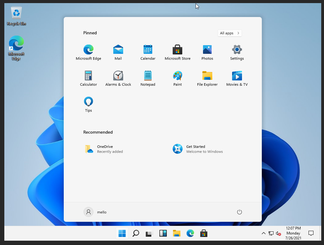

I'm testing virtualization on Scale and seems to be working fine; creating, cloning, auto start, all good so far. Even a Win11 VM installed without any issues:

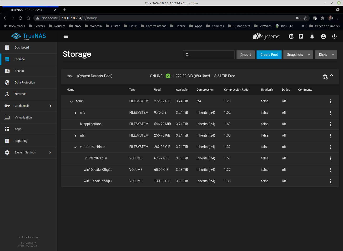

Has anyone converted ESXi VMs to Scale? I imagine step 1 would be convert the VMKD disk to a compatible format - not sure as I see zvols created for each VM, so assume those are the disks (?)

You'd need to convert VMDK -> RAW and then if you want to use ZVols, you'd upload the RAW file and "dd" it to the zvol in question.
# dd if=<path to RAW filel> of=/dev/zvol/tank/virtual_machines/ubuntu20-XXXX
Something like that :)
