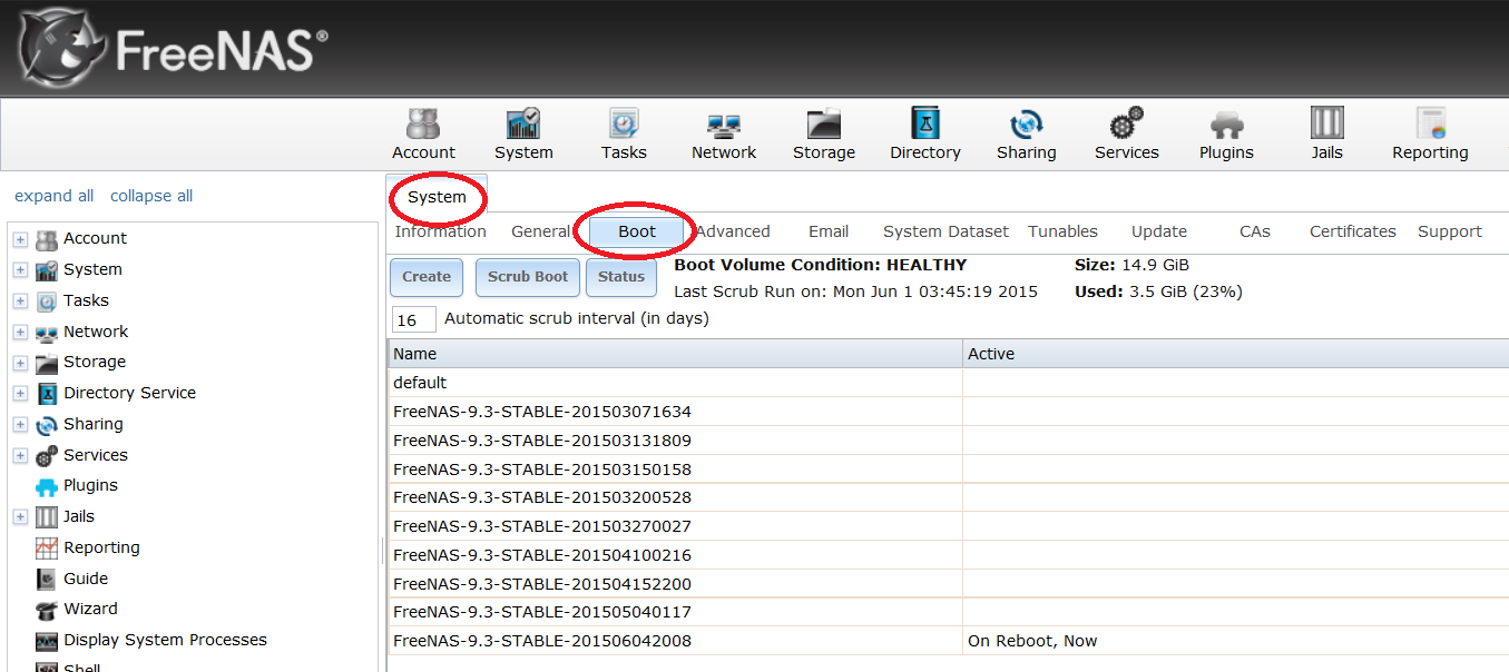

Please post screenshot of FreeNAS GUI of :
System/Boot window
See example in link below...
How full is the boot device?

There was an update bug a few builds ago and odds are you are using that build (can be conclusive since you didn't post your current version). The only way around it is to do a manual update.
The other issue could be a full boot device. (EDIT: okay someone beat me to this)

its a 32gb flash drive that I use for boot drive..

Your device says if you reboot it will be the current version.
joeschmuck
Old Man
May 28, 2011
10,996
Also, your current running version is free from the upgrade bug. I'd reboot.

doesn't it reboot after updating? Anyways I just started the NASbox a few hours ago. Anyways.. just rebooting.. will let you know in case of any issues. ty people... really love how fast people respond here... ^_^
Bhoot
Mar 28, 2015
241
works now.. thanks a lot.. :)
