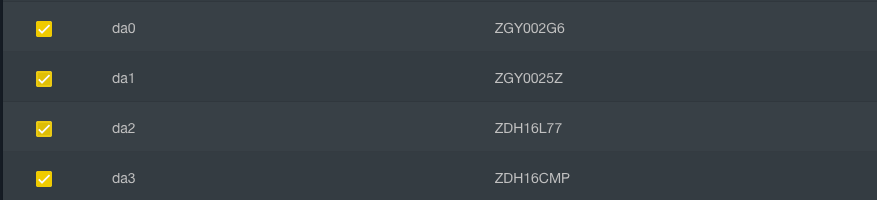

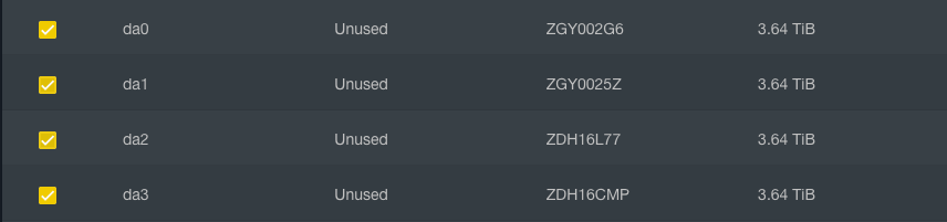

1st: 1|databank01|9906055174888524968|1|e7da5c5c-624b-4d0e-86bb-2afec29220c8
2nd: [no output]
geli.key
Edit: Second image. Since I started it up two days ago, it finally shows drive sizes.

So, my guess (hope?) is that what happened was the system wasn't ready to be rebooted and now just isn't sure how to decrypt your disks. It is interesting that you're getting databank01 listed in storage_volume but no disks in storage_encrypteddisk.
If possible, I suggest you look in /data/geli and make temporary backups of any files in there. They may not prove useful; but they might and it will be nice to have them on hand just in case.
So, you can try a few things from here. You can try to import the pool via the GUI, providing the recovery key that you have to unlock the disks. If that works immediately click on the pool and select "Rekey Pool" and download that key, then add a passphrase if you want one, and then click "Add Recovery Key" and download that key as well. These will be the new keys to your pool.
Alternatively; you can attempt to unlock the disks manually; import them via the GUI; then rekey, passphrase, and recovery key exactly as described above.
If you cannot rekey the pool you can try to copy your recovery key to /data/geli/e7da5c5c-624b-4d0e-86bb-2afec29220c8 .key. Remember from above that you should keep backups of any files in that directory before you attempt this. Once you do this; restart your machine and then if the pool is unlocked upon restart rekey the pool, reset the passphrase, and re-add the recovery key exactly as above. Again, these new two keys you'll download will be the new keys for your pool; don't lose them. If this works move back any files to /data/geli except e7da5c5c-624b-4d0e-86bb-2afec29220c8 .key.
Do note that if you choose to try one of the above steps it will be important that you keep copies of your new keys. And if you run into trouble it would be helpful if you record exactly what you did, exact errors, etc and try to report back without taking further unreported steps. If you're unsure of any of the steps report back; it is important you get it right else you may inadvertently make the situation worse.

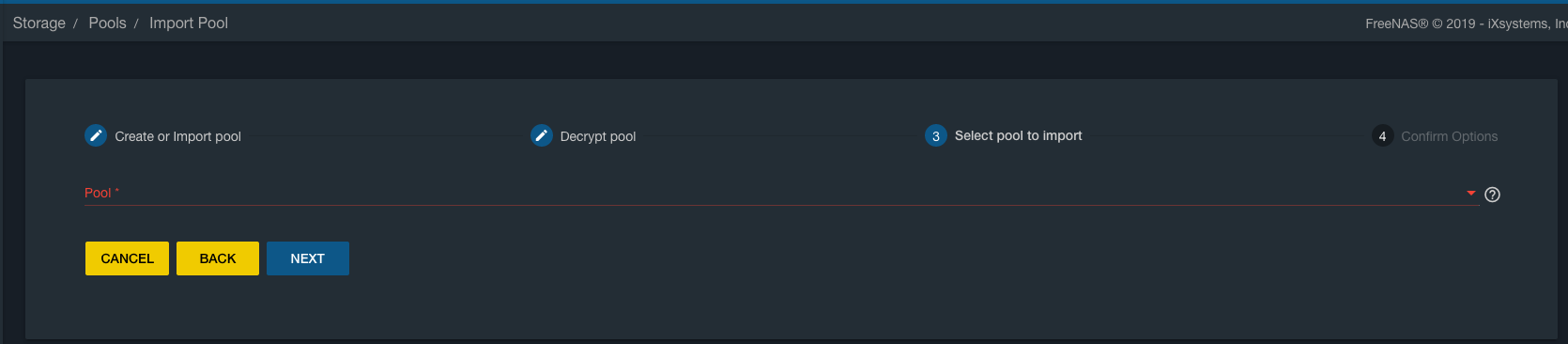

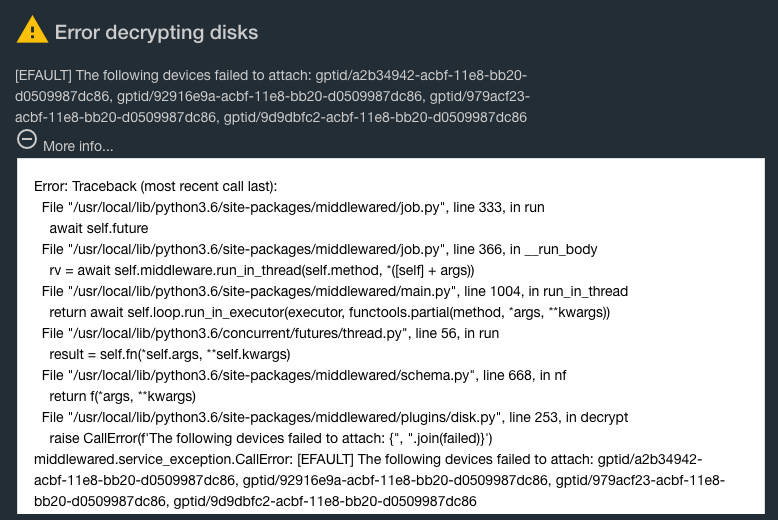

Says pool is degraded. Tab crashed so I'm gonna wait till everything has loaded up and the blue circle stops spinning. Id have to successfully get in to upgraded the pool I believe..
Added image after trying to import via GUI
Oct 18, 2018
969
Sorry for the delay, I've been in and out of internet a lot lately. Did you attempt any of the steps I outlined above to try to manually unlock your disks? My hope is that your system is simply unable to unlock your disks, if you have the correct keys this can be fixed.

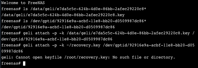

Here's the direct results.
Oct 18, 2018
969
Thanks. In the future, if able, copy-paste is preferred so I can copy-paste your output to reply and help clarify. :)
geli attach -p -k /data/geli/e7da5c5c-624b-4d0e-86bb-2afec29220c8.key /dev/gptid/92916e9a-acbf-11e8-bb20-d0509987dc86
It looks like this command worked.
geli attach -p -k ~/recovery.key /dev/gptid/92916e9a-acbf-11e8-bb20-d0509987dc86
Because the first command was successful, this one was unnecessary. Take careful not of my comments in this post where I said to attempt to use recovery.key only if data/geli/e7da5c5c-624b-4d0e-86bb-2afec29220c8.key failed. It further mentioned that if you did try recovery.key that you would need to copy it to your server using scp or similar. The fact that you got an error geli: Cannot open keyfile /root/recovery.key: No such file or directory. suggests that you didn't perform the scp step first.
I know it may seems like I'm being a bit nitpicky here; but I promise it is for a reason. :) Primarily it is because encryption can be tricky and it is important to enter every command in the correct sequence and to provide the full information so that I don't accidentally give you bad advice or you don't accidentally trash your pool by entering commands incorrectly or out of order.
Anyway, the good news it, it looks like the key you have in your system is the correct key, at least for one of your drives. What we are going to try next is to manually unlock each drive in your pool using the key that worked above, /data/geli/e7da5c5c-624b-4d0e-86bb-2afec29220c8.key. Go ahead and try the following commands. If they all work, navigate to pools and show me what it shows. If any of the commands fail then show me the exact command and error as well the output of ls /dev/gptid.

I understand the need to do things in the right order. You don't come across as nitpicky to me. That said, the only thing I can't do from my GUI is see the pool listing in this pane (see img). I'm not sure if it actually decrypted the drives as it went through that stage pretty smoothly. Kinda scary..
