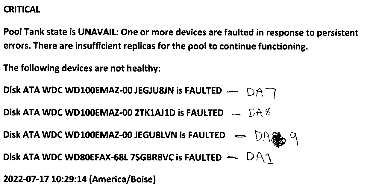

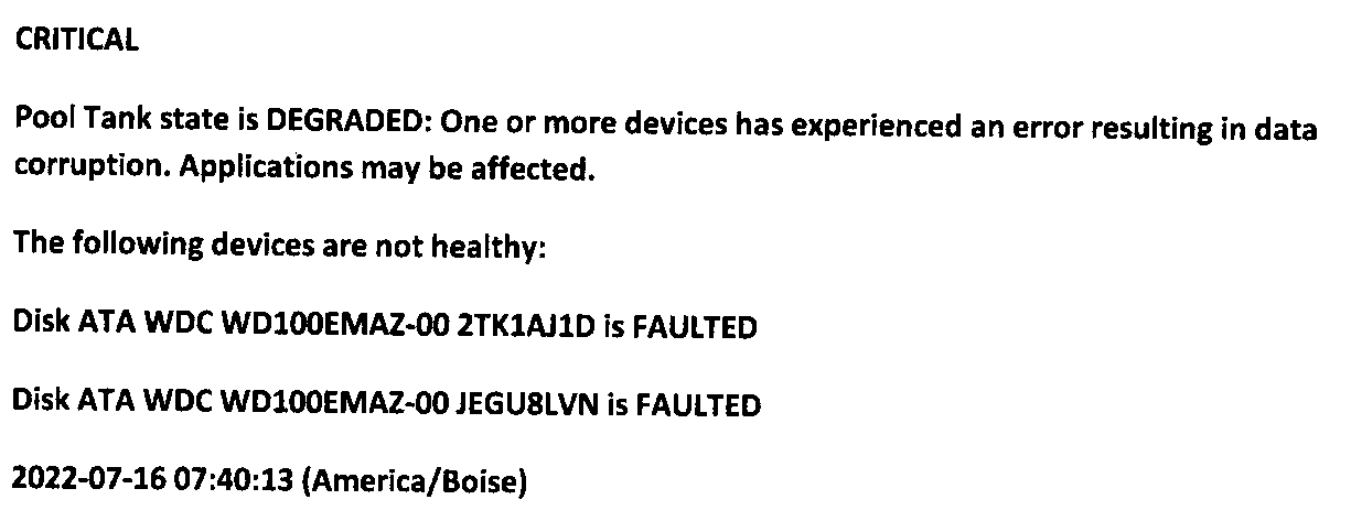

I am getting the following message in my FreeNAS Core 13
Pool Tank state is ONLINE: One or more devices has experienced an error resulting in data corruption. Applications may be affected.
2022-07-19 12:53:22 (America/Boise)
I am able to read and right the media folder that has been stored on the shared drives, but am having trouble with plex also.
The main issue is how to figure out the pool tank message above.
As a noob, I am just not sure how to figure this out. Any help would be appreciated. Thanks, Bob Ivey

The interesting part is that I am still able to access all of the media (movies, music, and other video's) and it is still all playing well. I access it via the network share. What would be the best way to test all of the drives on this server. I have plenty of time since I am retired.
An interesting thing is that the trouble that is showing now is data yet last week in was showing the following,
These images from a few days ago are not showing now.
