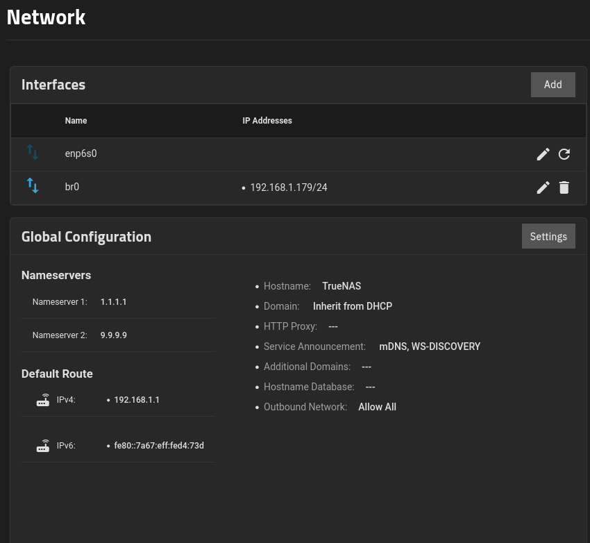

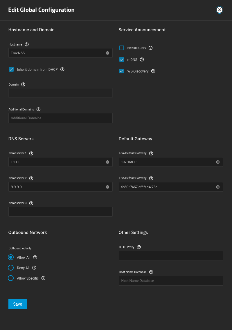

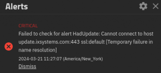

upgraded from BETA to RC.1 and got this new alert. does anyone know why? (also weirdly every time i reboot i get another error that says it failed to sync the truenas apps catalog which i can clear by simply refreshing the apps catalog manually but its super annoying to have to do every time on reboot). both seem to be either network or dns issues so i have included screenshots of both for clarity.

William Grzybowski
May 27, 2011
1,754
Its possible your network is not ready at the time TrueNAS boots.
Are you using DHCP? One possibility is that its taking too long to acquire the IP.
Perhaps try a static one if thats the case.
Logs could be helpful to diagnose the issue.

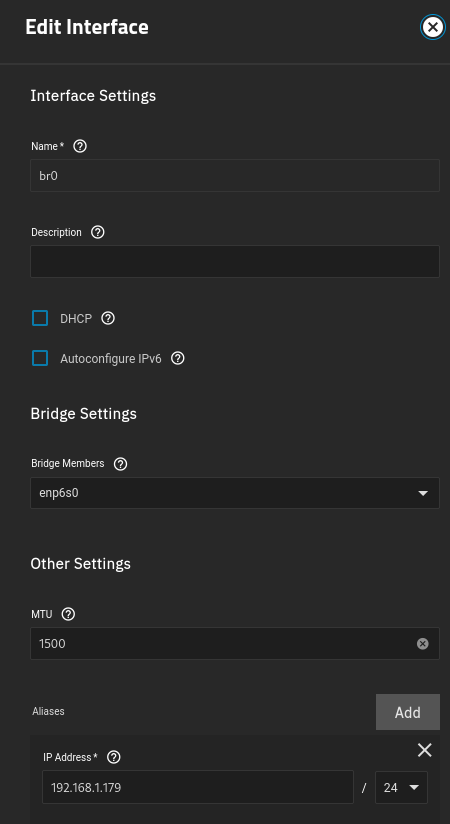

it definitely feels like the network isnt ready at boot. what logs should i put here to be useful?

William Grzybowski
May 27, 2011
1,754
Can you try to uncheck "Inherit Domain from DHCP" and remove IPv6 default gateway?
They could be getting in the way somehow.
that solved the issue of not syncing the catalog but i am still getting the "Failed to check for alert HadUpdate: Cannot connect to host update.ixsystems.com:443 ssl:default [Temporary failure in name resolution]" error.

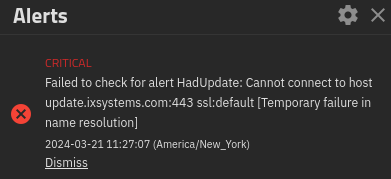

Any other fixes for this particular error that comes up randomly, it happens about 3-6 times per day. Eventually I will get an E-mail that says the alert is cleared. **Note- I had to manually update from Beta to RC.1 - would not download update but did see the update.

Yep. Just restarted my DragonFish.RC1 system again, and the "critical" warning came back again. As this is the first "scale" update I've applied, I don't know if this behaviour existed before, but it didn't occur when I upgraded to Cobia from CORE.
And yes. The name resolution isn't available at startup, but I would think that a NAS can't assume that the internet is available either.

@newguy123 Where is the local DNS server pointed? I see two public ones but no local one.
