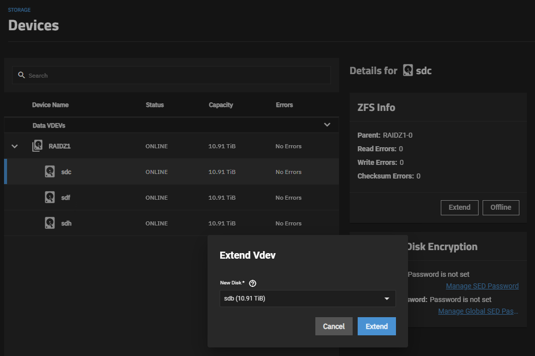

I am getting the following error if I try to extend my RAIDZ1 Vdev:
  File "/usr/lib/python3/dist-packages/middlewared/job.py", line 426, in run
    await self.future
  File "/usr/lib/python3/dist-packages/middlewared/job.py", line 461, in __run_body
  File "/usr/lib/python3/dist-packages/middlewared/schema.py", line 1284, in nf
  File "/usr/lib/python3/dist-packages/middlewared/schema.py", line 1152, in nf
    res = await f(*args, **kwargs)
  File "/usr/lib/python3/dist-packages/middlewared/plugins/pool_/attach_disk.py", line 46, in attach
    verrors.check()
  File "/usr/lib/python3/dist-packages/middlewared/service_exception.py", line 70, in check
    raise self
middlewared.service_exception.ValidationErrors: [EINVAL] pool_attach.target_vdev: Unable to locate VDEV
This is the menu that I am using:
NugentS
Apr 16, 2020
2,947
You absolutely cannot do this with a Z1. YOu can extend a single disk to a mirror, but you cannot add a new disk to an existing Z1 vdev
The only way of adding a 4th disk to an existing Z1 vdev is to trash the vdev / pool and start again. Do you have reliable backups?

Thanks, in this case the UI should not offer the function....
